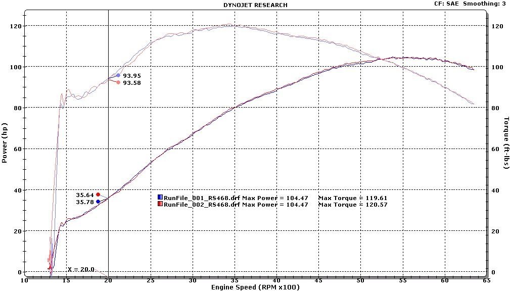

Here is the dyno run my bike made 120 ft/lb of torque with the RS 468. I was running the stock head pipe decatted, the stock muffler cans with Fullsac cores, and an Arlen Ness Big Sucker I for the stock cover.

As you can see the 22x did not perform quite as well with my setup as the RS 468 did.

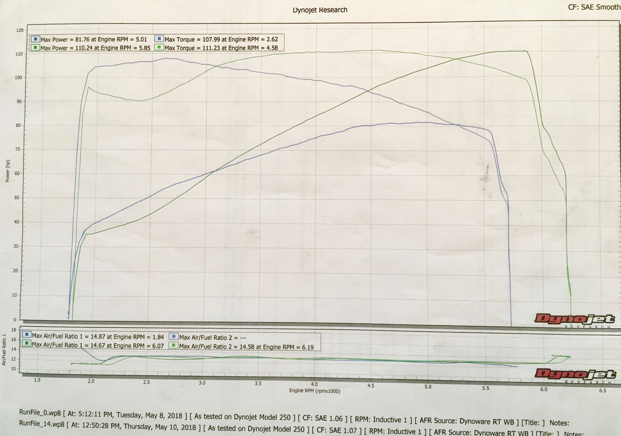

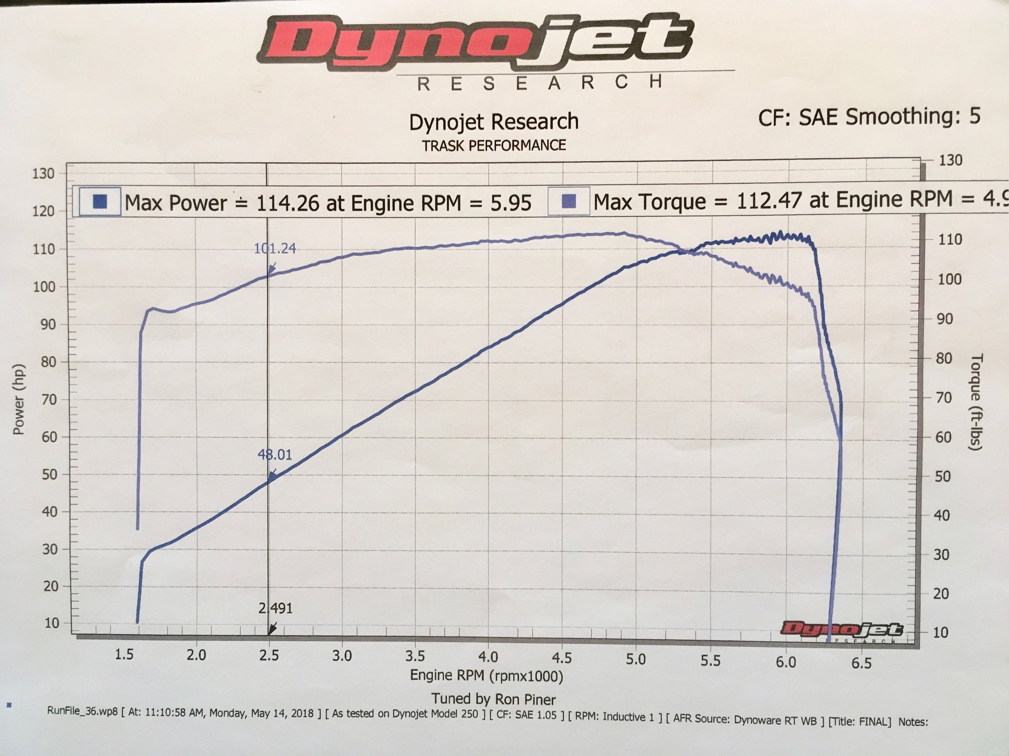

Here are my dyno charts from my recent cam adventures. The one with the large dip is with all of the baffles removed. It felt as bad as it looks. Really weak all over and in need of more tuning. The other dyno graph is from Trask Performance and shows the torque back where it should be but still soft under about 3k. Highway roll on in 6th gear is still better than stock but softer than I was hoping for. I'm talking with Fuel Moto about my options for installing their CVO 124" Big Bore kit.

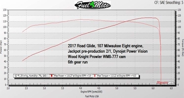

Well the chart on this looks like the typical graph of a 107 running the 777 cam. It seems something is going on with your bike that is holding it back from making the additional power that a 114" should make compared to a 107". What are you using for an air cleaner?
