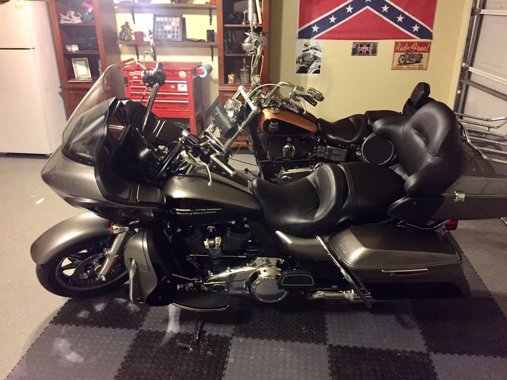

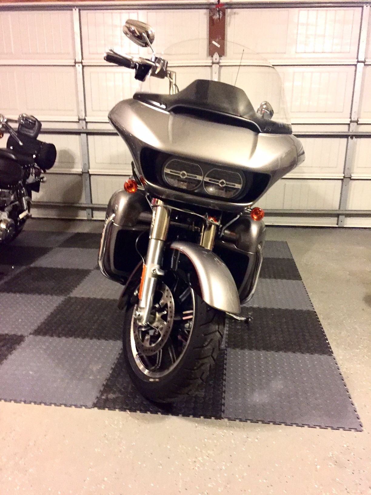

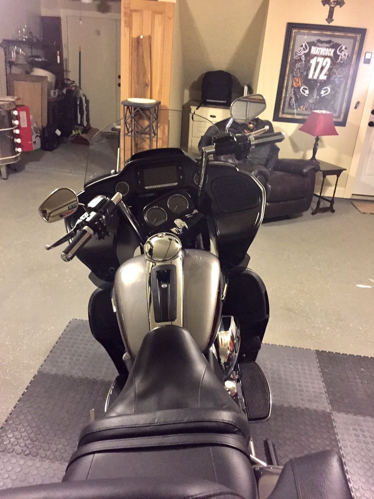

I am 6'7" on a 2017 RGU and yes the stock bars are no good for anyone that tall, my biggest issue was no so much the hand/arm position but the fact the bars were so close to my knees due to long legs. I am not a fan of really tall apes and like my hand position to be at about nipple level. I went with 12" Spooky Fast bars which opened up the space from my knees to the bars as well as put my hands at the same height that I ride on my Wide Glide. In addition the Mustang seat that I replaced the Stock with puts you back 1.75" so this also helps put you in the position that you are back further from the bars. You prefer the grips with more of an downward angle, these bars have some slight pull back so they are not straight across but they do not really angle down.
Here are a few pics for reference

Thanks for the reply. I too have a Mustang seat that moves you back and down. I like that the grips on your bars are straighter and don't angle down. That's what I was hoping for with mine, but I had to pull them back so far to keep from hitting the windshield that it rolled them back where the grips angle down now. I had Ballistic relaxers on my 2012 FLTRX and loved the feel of those but I don't think they would work on Road glide ultra.
