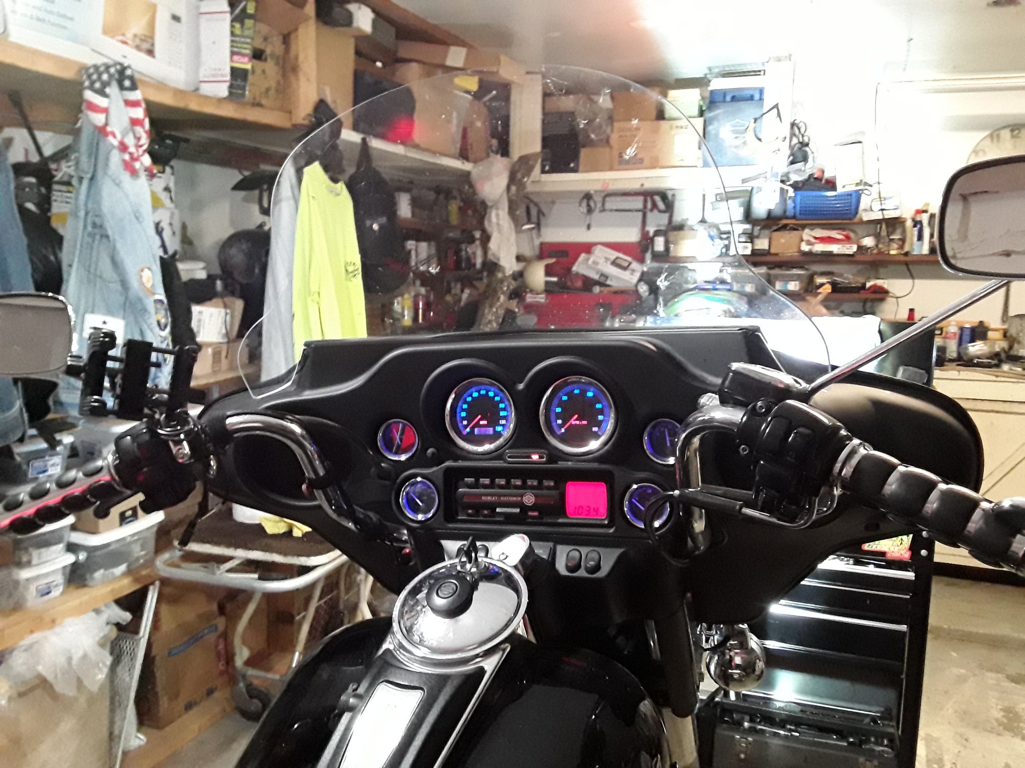

I also experienced the same problem with the 8" stock handlebars being too far forward on my Ultra. I tried moving them back a couple of inches but they were still too far forward and too low and uncomfortable after a couple of hours. I wanted to keep the stock look so I replaced them with Paul Yaffe 10" Classic Apes. The stock throttle and clutch cables and brake lines would not reach and I replaced the throttle cables with +4" Hill Country cables, the brake line with a Magnum +4", and a Diamondblack +4" clutch cable. (I used the longer cables just in case I decided to go higher with the apes in the future). The wiring length was sufficient for the 10" and maybe even for the 12" but I am not sure they will work with higher bars.
The reach is much better and the look is still stock like I was going for, but I think the 12" would have been a little more comfortable.
