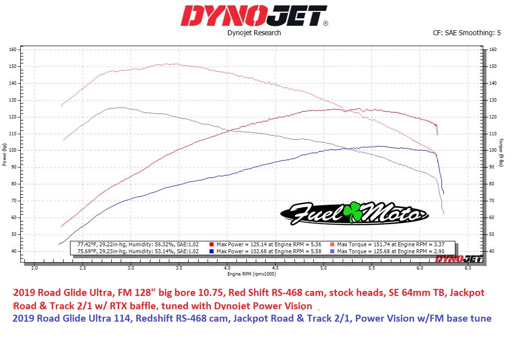

BatOuttaHell's FM 128" combo. You can follow his voyage here>> https://www.hdforums.com/forum/gener...ispreloading=1

awesome job to all involved power right where you use it an lots of it !
