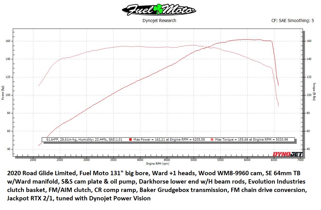

2020 Road Glide, Fuel Moto 131' big bore, Ward +1 heads, Wood WM8-9960 cam, SE 64mm TB w/Ward manifold, Darkhorse lower end, S&S cam plate & pump, Evo Industries clutch basket, Baker Grudgebox transmission, FM chain drive conversion, Jackpot RTX 2/1, Dynojet Power Vision.
