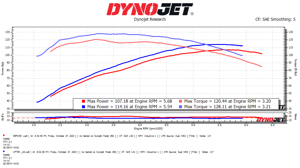

22 Road Glide ST. Redshift 468 cam, Jackpot RTX 2-1, Powervision 3. Red line is a canned map after 3 autotune sessions. Blue is tune.
114 hp. 128 tq.
