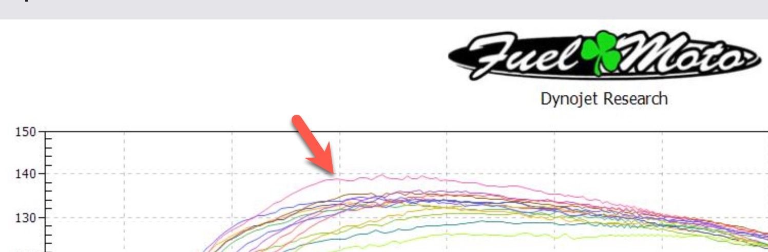

OK, so lets cut to the chase and help us out here @fuelmoto , what cam is this?

I edited the post to include all of the individual charts. The trace you are referencing is the CR-480MT

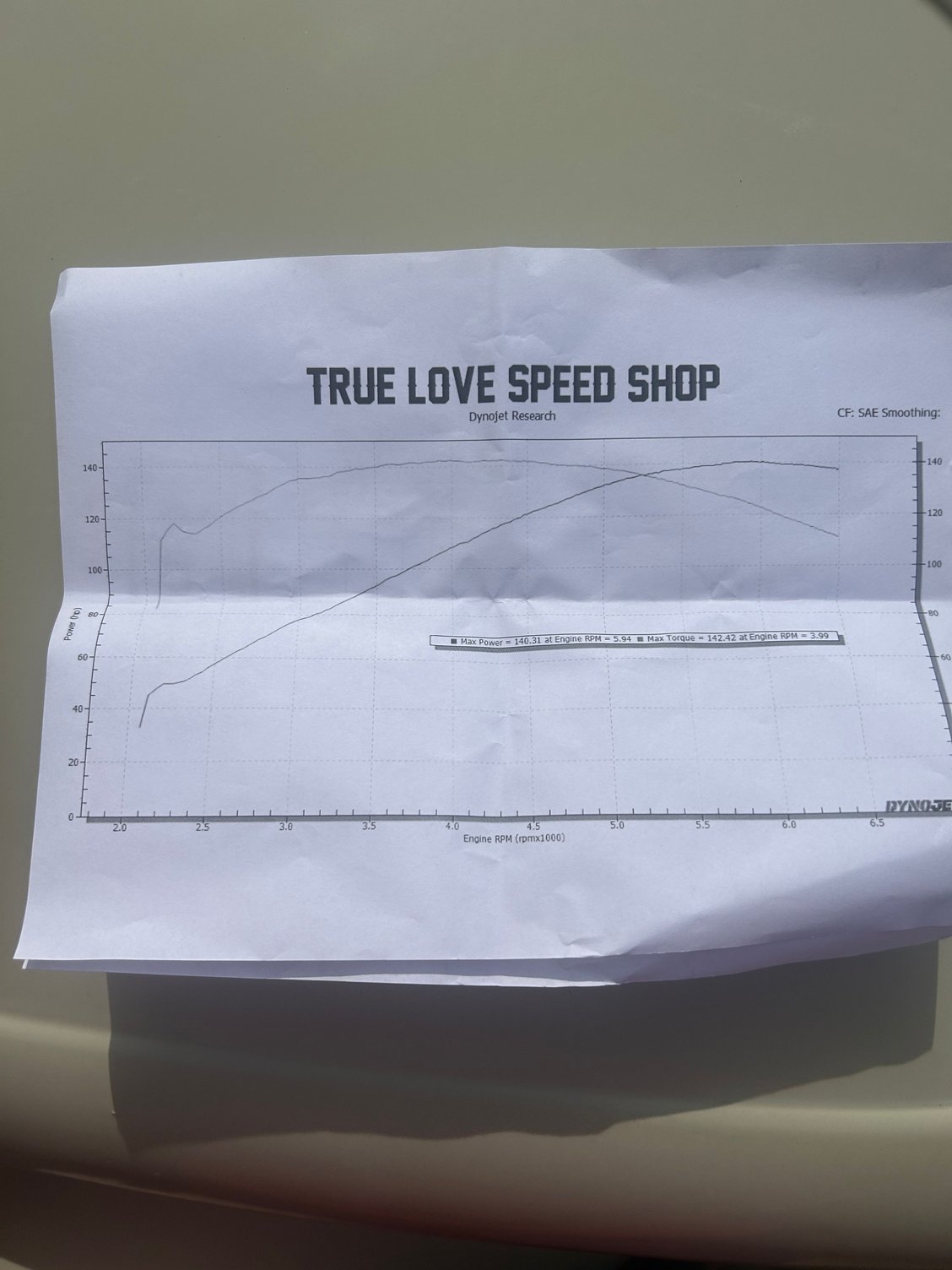

Drop in slugs n jugs 124. SE Ventilator extreme
SE64 ported manifold, Stock heads, 6.2 injectors, Star F35A, S&S Super street.
140 HP
142 TQ

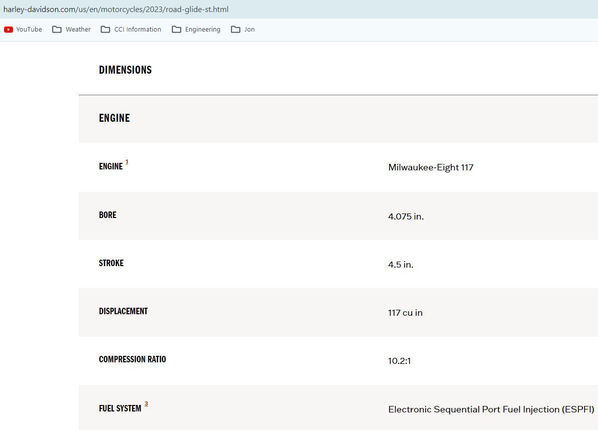

What's the C.R. on the 117 ST?

11.4:1, according to HD.

I believe it is 10.2:1.
