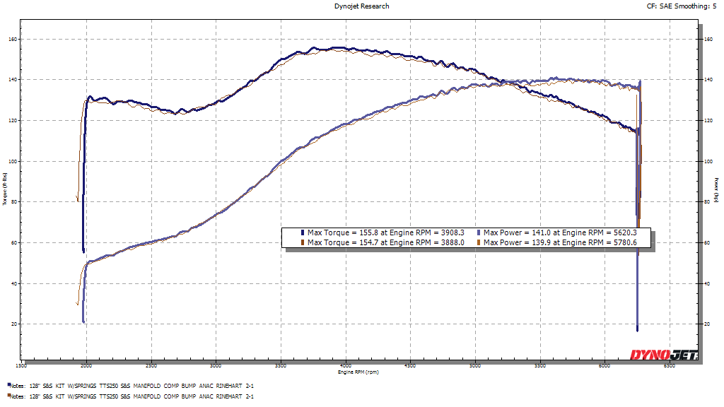

Buddy brought his 2018 Breakout down. Turned out pretty healthy!
S&S 128 BB kit with new valve springs, TTS250 cam, substituted .030 head gaskets +.010" base gaskets, Rinehart 2-1, VTP 55-60 manifold, stock 55 throttle body, stock heads. Could use a better exhaust, but it does get along pretty well

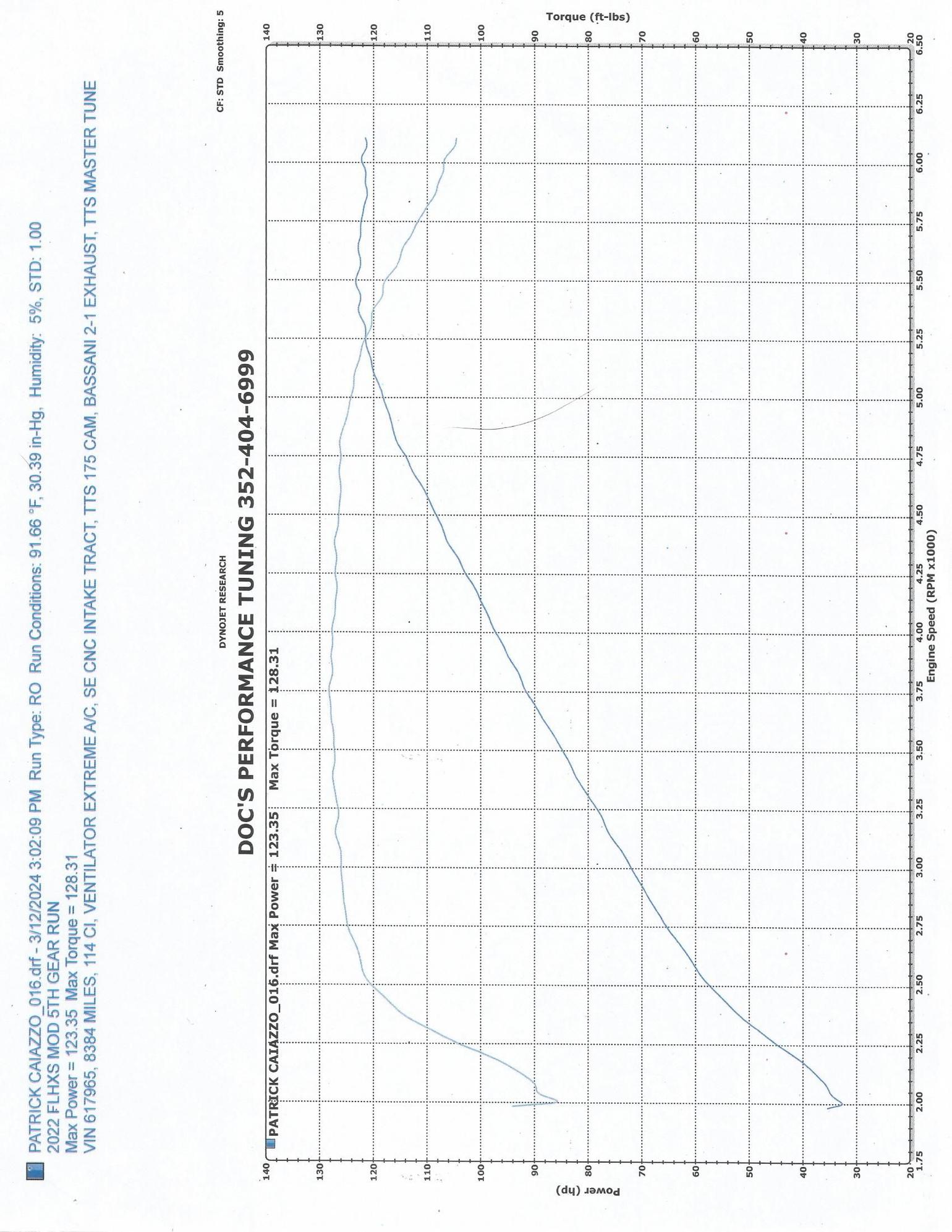

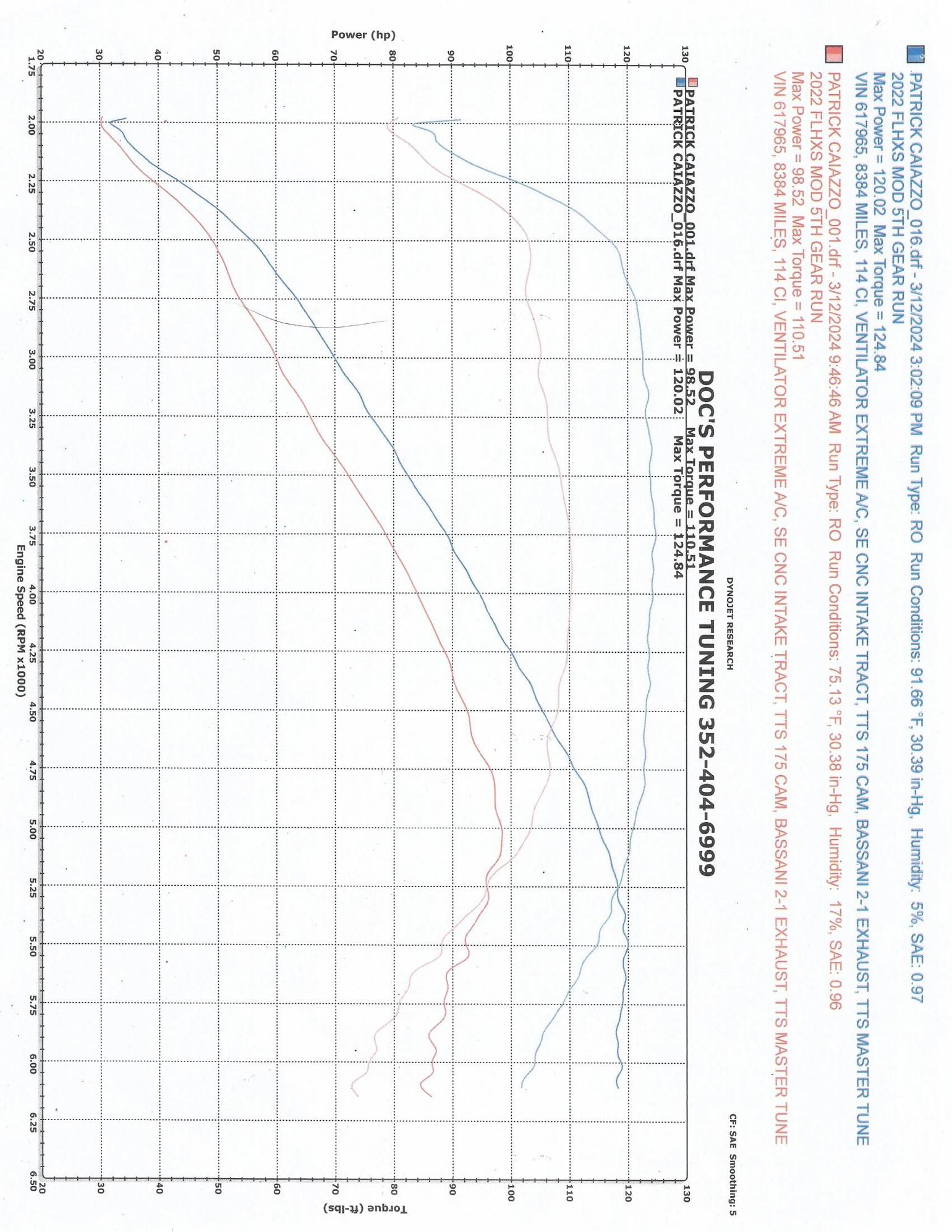

[QUOTE=Bayou FLHR-M8-128";21591663]Have seen many 114 Stage 2 dynos show in the 125 hp range.
That's about where I ended up.

What injectors?

That torque 🙌👍💪
Awesome Man!

GMR 6.2 from VTP, when he got the intake manifold.

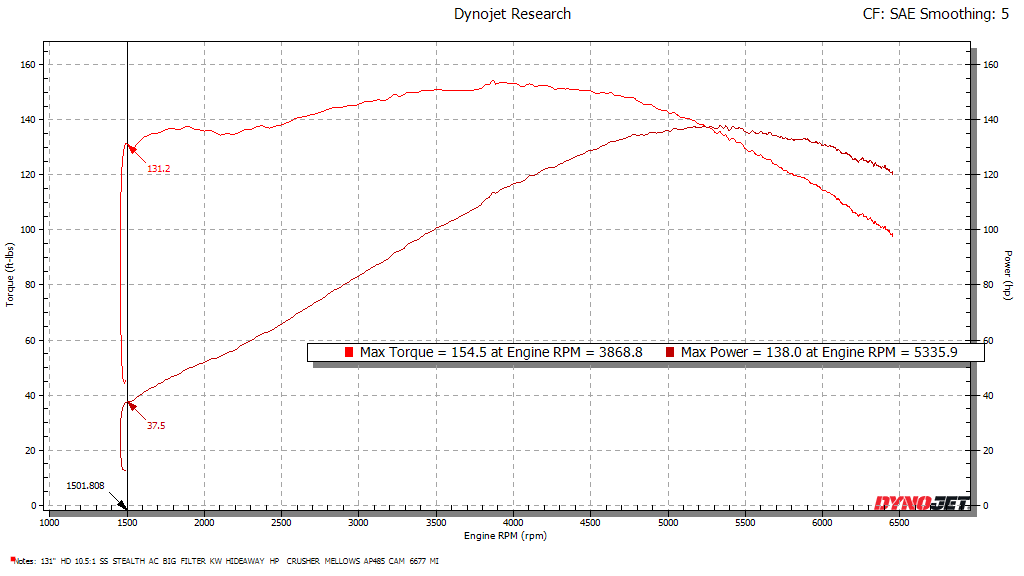

2019 FLRT 131HD cylinders Suburban Speed 10.5:1 pistons Andrews 485 cam Khromewerks Hideaway head pipe Crusher Mellow mufflers SE64TB & manifold FM 6.3 injectors S&S Stealth AC with 1" taller filter element.
