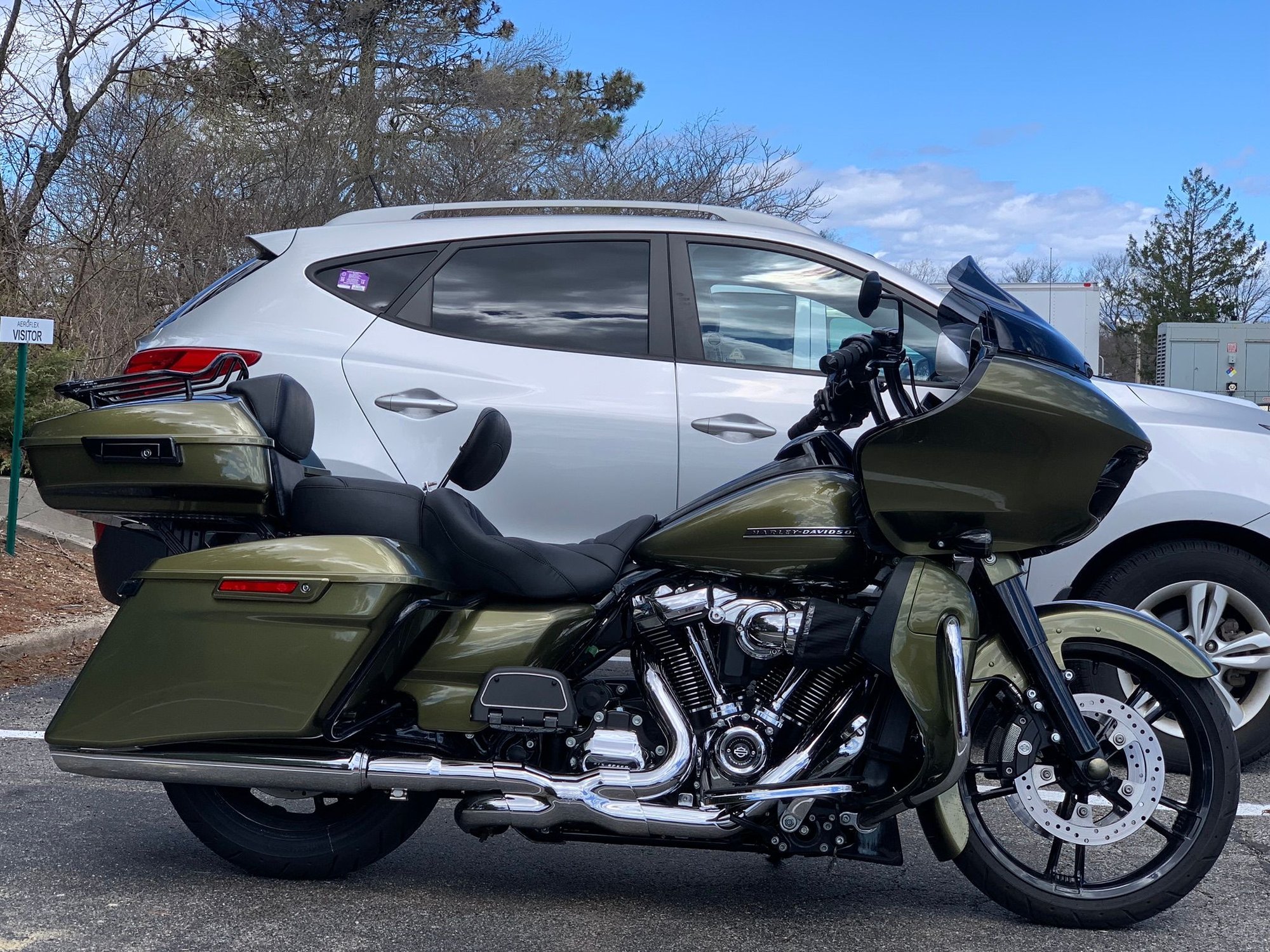

Ok so only green road glides sump
Got it
