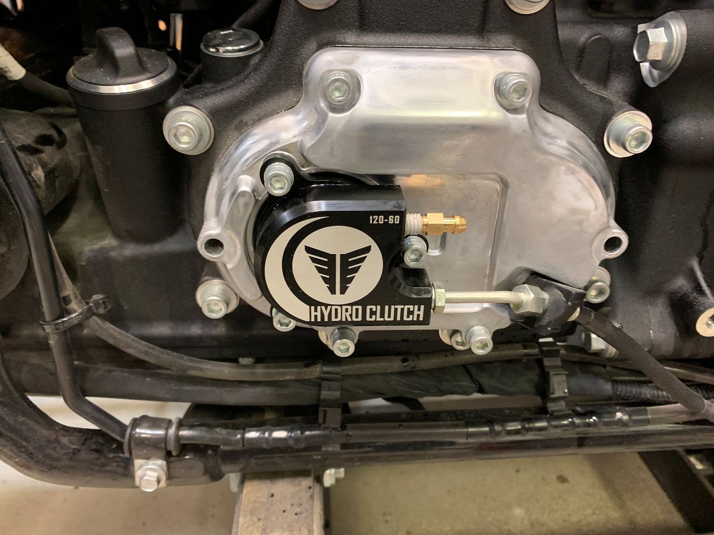

Love my Muller! Convinced a friend of mine to put one in after the AIM SDR clutch upgrade, and he loves his too.
Gravity bled mine, then did a quick traditional bleed. Left for a 6K mile trip 2 days later, couldn't be happier.
Because pics
