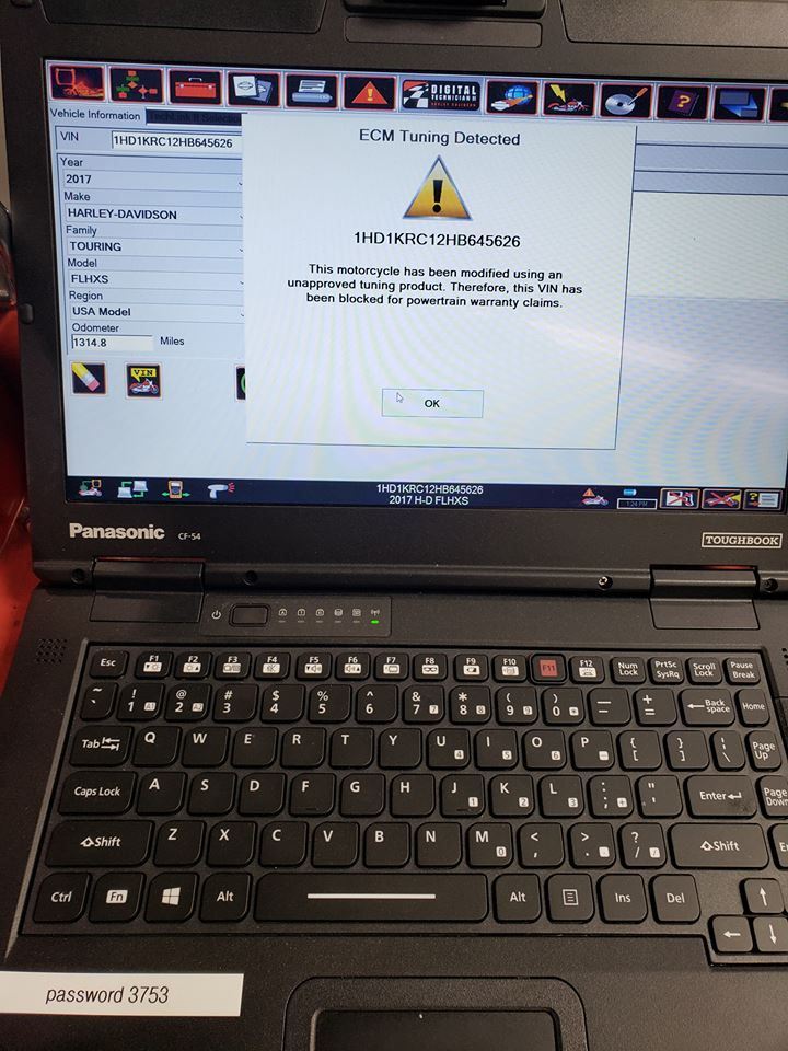

So if anything happens to my engine I will take it my local dealer who said if they do the work, they honor the warranty but if somewhere else I will upload the Harley provided map (stored forever in location 1 on the FP3) disconnect the FP3 and smile.
it isn't going to matter if you upload the Harley map or not, the digital tech is going to know that your ecm has been flashed with a 'non approved' tuner. your smile is going to quickly turn into a frown when they say 'denied'.

well, there's this:
somewhere on one of these forums, i've seven a screenshot of the digital tech plugged into a bike with an 'illegal' tuner on it. can't seem to find it now.

Looks like this-

Originally Posted by rigidthumper
Looks like this-
wow, surprised they didn't use this on their display

yep, that's the one...

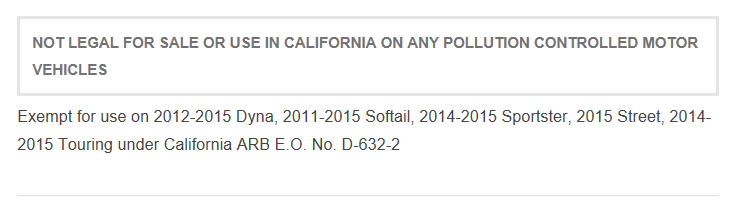

Interesting. V&H actually has a CARB compliant tuner. I wonder......
Old Jul 29, 2019 | 12:40 PM
skratch's Avatar
skratch
Joined: Jan 2007
Posts: 20,616
Likes: 4,440
From: anacoco, la
take a look at the year range for that tuner. and because it is carb compliant, it is nowhere near as capable as the other one.
