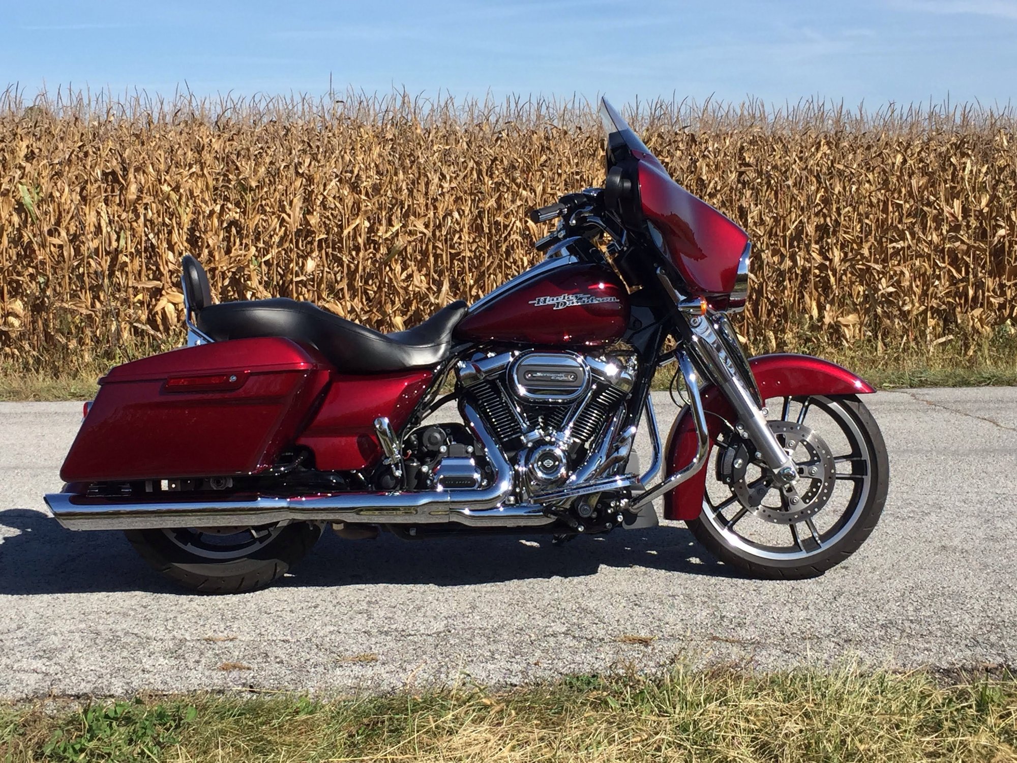

I purchased my 2017 Street Glide in September 2016 after break in with 2000 miles had a stage 3 big bore kit installed with decatted head pipe,twin slash exhaust,power vision tuner,air cleaner,etc which was heat cycled and broken in on Dyno by a very reliable engine builder which I think is a must! I now have 15,000 hard miles with no problems other than minor recalls.
