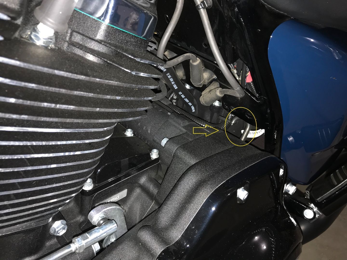

Cheers bro thanks for the Photo of the vent

Here's a shot of mine, in case it's still not clear for some. I circled it, and put in an arrow pointing to it:
