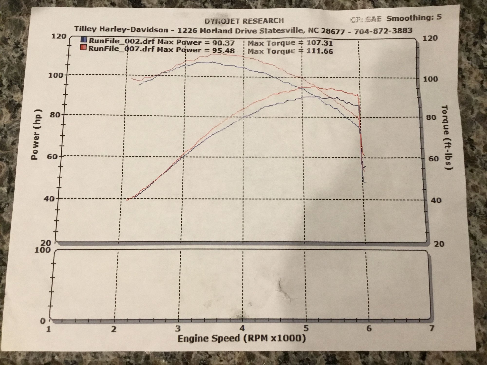

I didn’t pick up as much TQ as I remembered but I did pick up 5hp and 4lbstq. The before was HD stage 2TQ cam, SE Street Cannon slip-ons and HD SEPST with the stage 2 download, it was the 107 motor, not the current 114 they put in the specials. The after was with the auto tuner and S&S exhaust. As I mentioned before the bike was not tuned on a dyno just has them do a couple of pulls to see what the increase was. It might just be my thinking but the more I road the bike after the installation of the auto tuner the better it road. I put about 3,300 miles on it in 3 months including a trip to Milwaukee for the HD 115 party. I know the guy that has it now and he absolutely loves it.

Thank you. I have heard other people express the same - that it seemed the more they rode a bike with auto tune the better it seemed to run.
