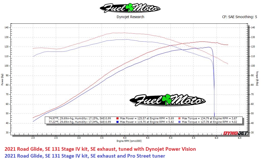

We've done many SE 131's with just exhaust & tuner swap, they really respond well. Here's a 2021 131" bike we just did a Power Vision tune only on last week, this bike had SE head pipe & mufflers, we typically see +5-7 Hp/Tq with aftermarket head pipe or 2/1

Appreciate the info on the Power Vision only tune. Looks like there is a bit of power over the SEPST but the real power is going to require a cam and exhaust swap. Still really easy to get to 150/150. The bike does run really well making the power now but I bet 150/150 is another level. Someday....

Jamie, I know I'm jumping on this late but could you post one of the dyno sheets of a 131 with just an exhaust and tune.
