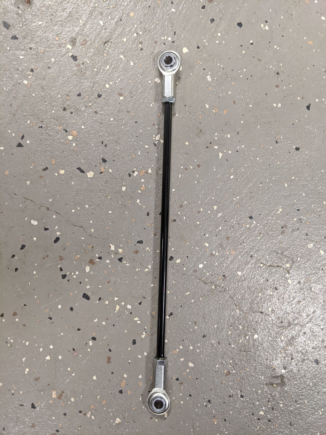

39,000 on my 2017 and 35,000 on wife's and felt the same as new..not like the flopsy mopsy Twin Cam linkage lever problems..glad that problem was resolved with M8s..haven't heard a thing about them in 4 MY now..always ditch the ball and socket OEM rods in favor of the heim joint versions

I had the stock shifter rod powder coated gloss black and installed these 5/16-24 stainless heim joints. Getting ready to bolt her up. This thing will never fail.
