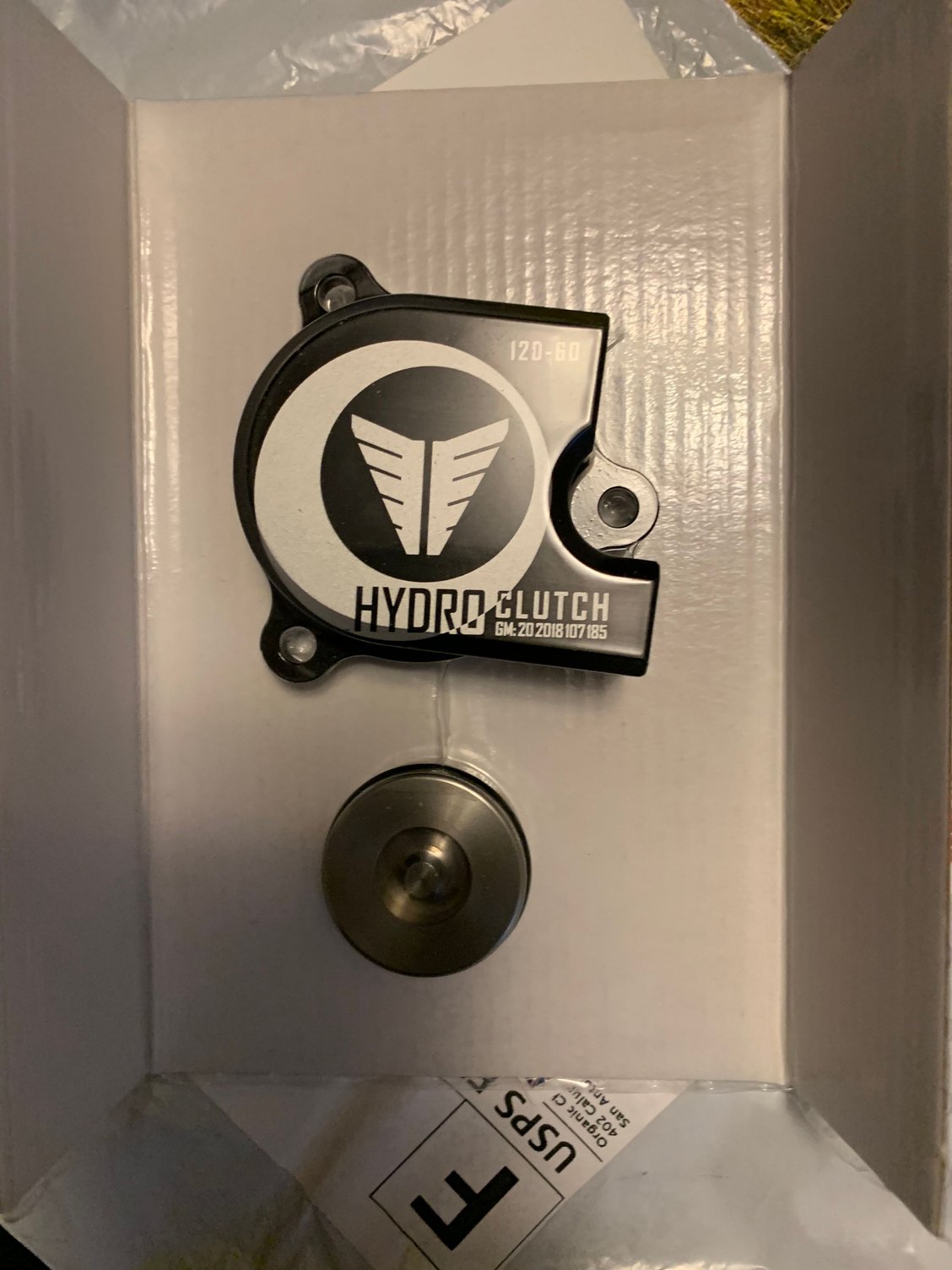

I've had a lot of Harley's and frankly was not convinced the hydraulic clutch was an upgrade. The cable clutch had a much lighter pull and was easily adjusted. The M8 has the strongest clutch pull of any Harley I've owned. Years ago that wouldn't have been an issue but as we age it is not uncommon to have issues with arthritis, carpal tunnel, and in my case an issue called "essential tremors" that was inherited. Had no trouble pulling it in as that is simply a strength issue it was letting it smoothly that became an issue. That being said, I decided to install a Rekluse Slave cylinder on the M8 to reduce that pull and change where it engages. Probably would have been a 2 hour install if they would have sent the proper size bleeding tube, it took longer simply to bleed it for that reason. Anyway if any of you need to reduce the hard pull on your clutch for any reason this will do it for sure. I may have to go to the Rekluse Radius X auto clutch if my condition worsens, time will tell.

I have a built TC with the AIM clutch and a their spring that is in between the SE HD spring and a std 103 spring and it is way easier of a clutch pull than the hydraulic versions. It's not so much the force but that is part of it but the resistance is the same full out to full in. When your hand is fully extended where the release point comes in is very annoying. Having owned many European and Japanese bikes with hydraulic clutches you would have thought Harley would have done a better job getting this right.
I may end up installing one of the after market slaves to mine going forward. Arthritis kicking in doesn't make it any easier to negotiate the damn clutch.

I agree ....had issues with the engagement point all the way out at the end. got the AIM unit and have not given it a second thought.

You would be appalled at my clutch pull. Stiffest springs offered with the AIM variable clutch. Still rocking the OEM slave. I'm used to it, and actually like it.

I put in the Radius Auto Clutch on my trike and love it. Other than shocks and a lift kit, probably the best install I've done!

I installed this and haven’t looked back.

I have a recovered busted up hand, and the OEM clutch hurt like heck. The AIM slave cylinder was a significant improvement.
