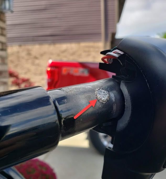

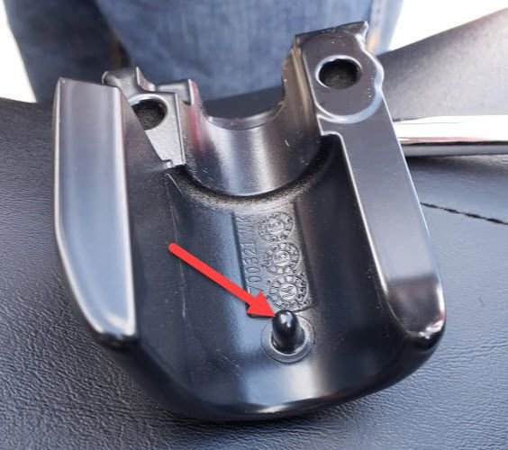

There is some minor surgery involved - pins on the riser clamps, switch housings, and handle bars near the grips need to be removed. The switch housing ones are a bit tough because you have to basically chizel them off while they are not on the bike. Not a huge deal, just a pain in the ***. I don't have a pic of the pins on the riser, sorry.
First pic is of the handlebar once that pin was removed.

Originally Posted by Keithhu
If you grab that with a pair of vice grips and wiggle it back and forth, it will break clean off. I ground down my first pair doing my best not to remove my own skin with a 10K RPM cutoff wheel (I'm dumb) until I figured this out.
Vice grips worked for me as well. Then a dremel tool to smooth out the rough edge left. Also the pin in the riser can just be knocked down flat. No need to remove it.
Agree, used same methods
Smack that little boss on the clamp with a drift pin and a nice sized hammer. It will break right off. I posted a vid on YouTube
