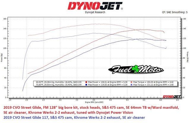

I picked up 19 hp and 19 tq going from stage 2 to a big bore, seat of the pants is a huge difference in every part of the rpm range, zero regrets, it's awesome!

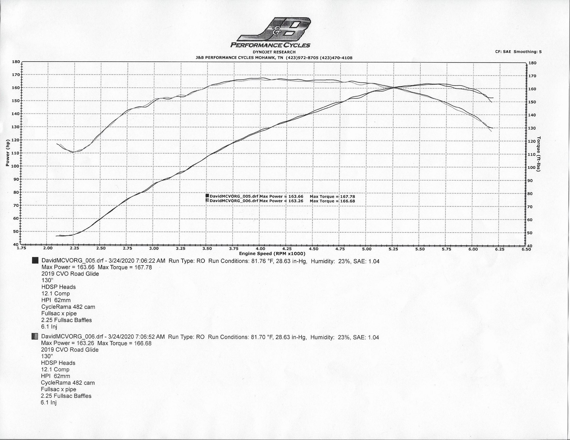

Exactly. For me, its not bragging rights. Its fun to ride, easy to ride, smiles per mile. 120 torque before 2500 rpm is a riot. 150 torque from 3000 to 5750 rpm is just fun. Worth every bit of the money spent on the build. I have put 21,000 plus miles on the build. My bike has nothing on it to indicate its a big bore.
