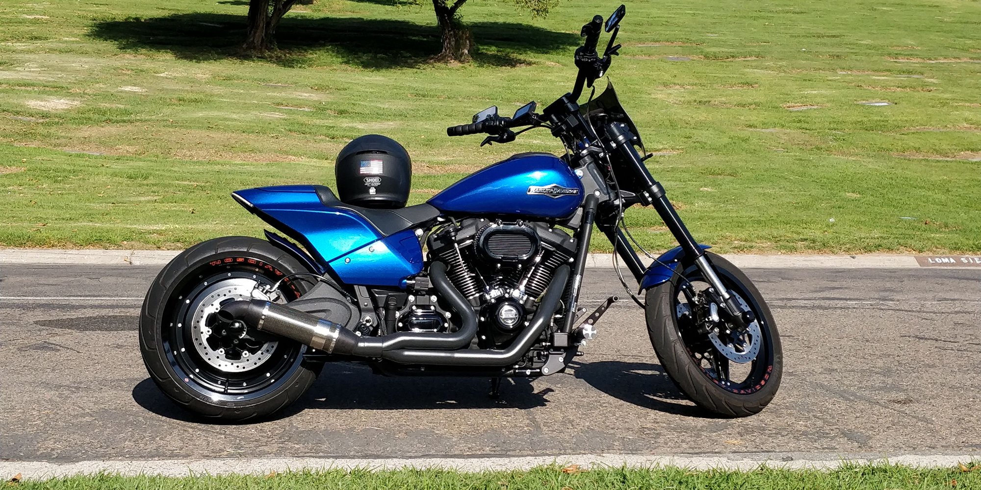

How about a real Street ShootOut ,Old fashioned dragrace ??
475c
