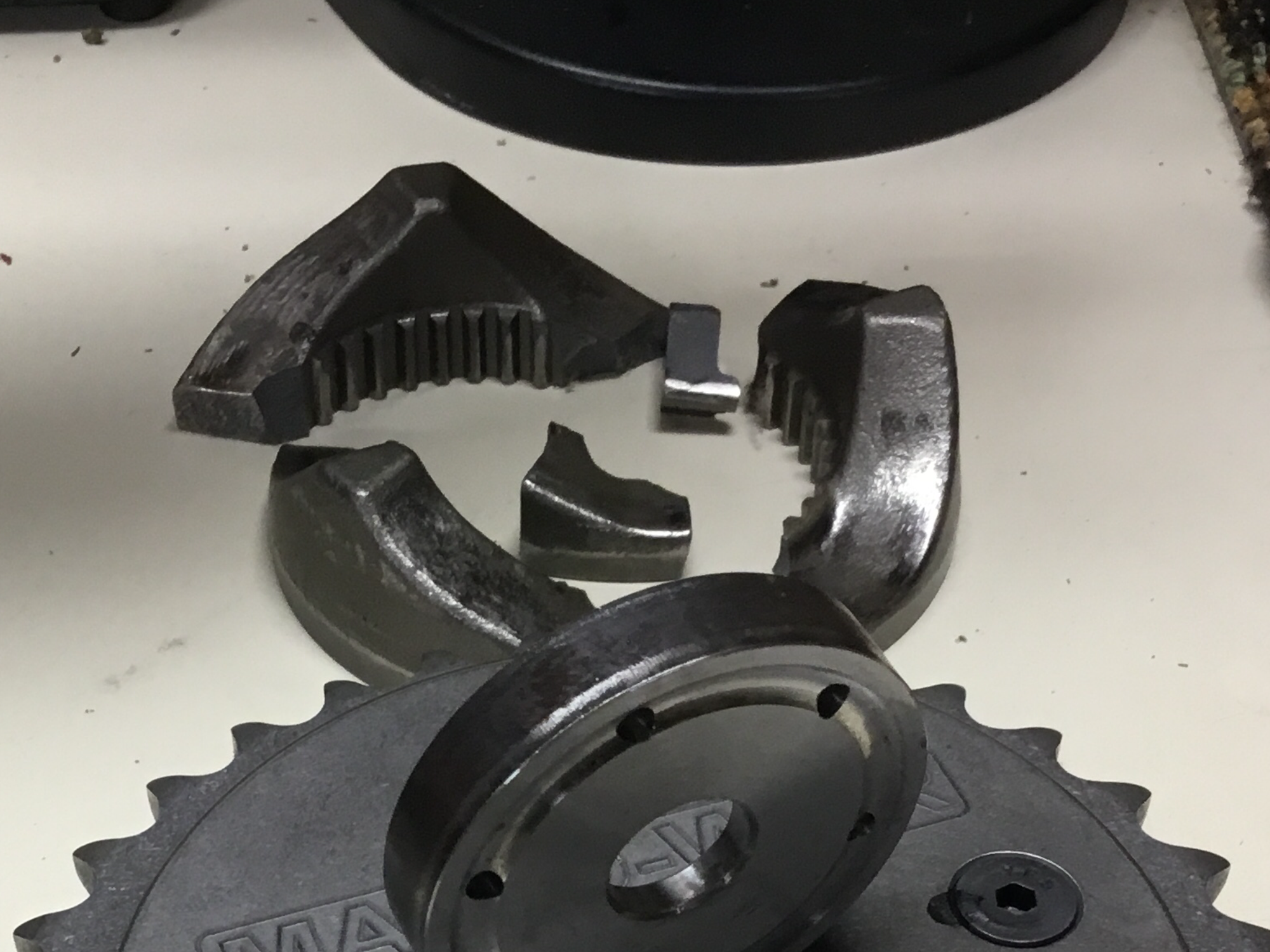

Originally Posted by TriGeezer
An M8 with a Stage 2 will not tear up the stock compensator. If you’ve got a highly built stop light to stop light racer...maybe then maybe consider. It’s extremely rare for someone to grenade an M8 compensator.
All it took for me was a miss shift between 3rd and 4th.
