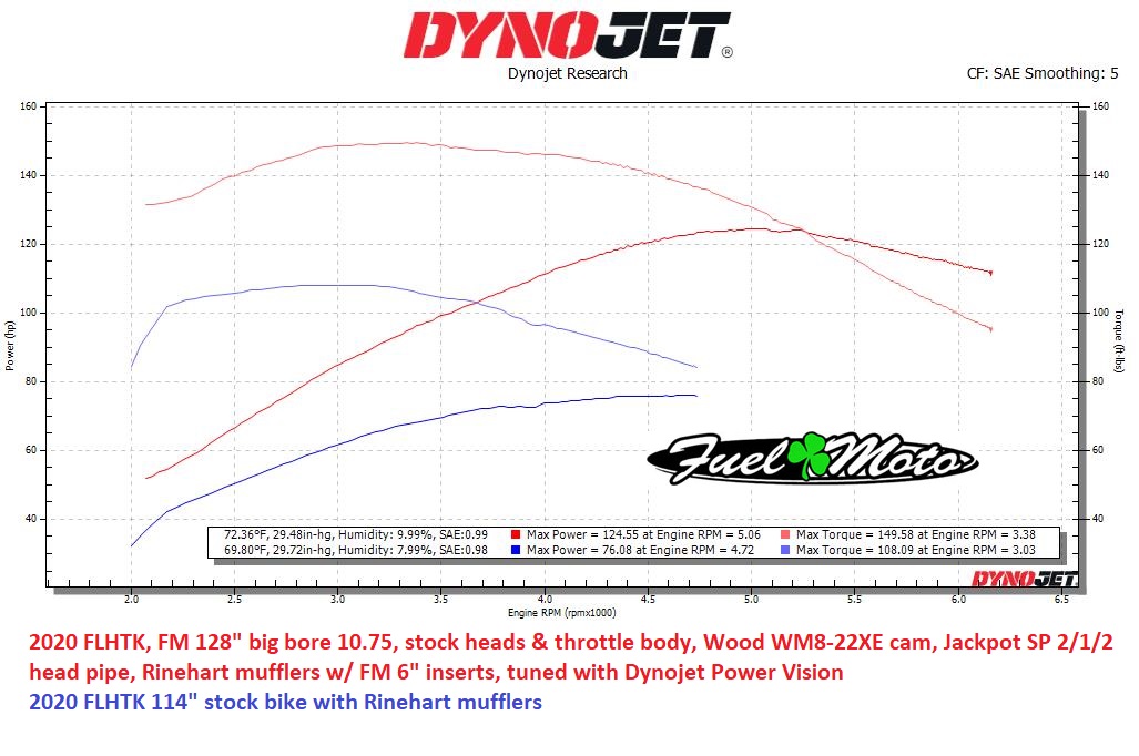

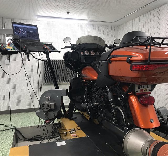

Finishing up the dyno break in and Power Vision tune tonight, its a torque monster!

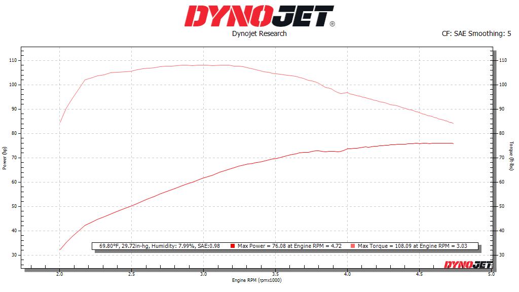

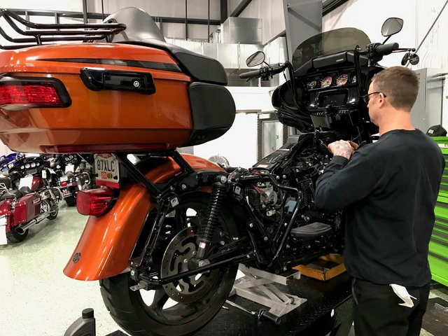

Originally Posted by fuelmoto
engine teardown in progress
baseline dyno run
damn, it was more of a dog than I thought!

jester0618's 2020 Ultra Limited, FM 128 big bore kit, Wood WM8-22XE cam, stock heads & throttle body, 5.5 injectors, Jackpot 2/1/2 SP head pipe, Rinehart mufflers with FM 6" inserts, tuned with Dynojet Power Vision
