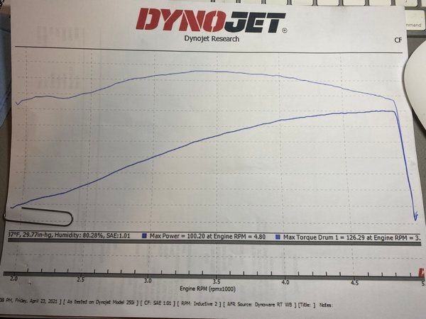

They are just slip on muffs. Here you go!
The 119 kit included a new header.

Very interesting. That looks pretty close to the graphs HD publishes for the 107/114 stage 3 kits, but your peak torque is higher than what they publish and your HP a bit lower. I was assuming the 119 kit would be higher all around, but I guess the 5 cubic inches from 114 to 119 doesn't make a big difference given all of the other variables in a tune. Either way, that is a very good outcome, and I can't wait to put the 119 kit on my bike. Thanks for posting this!

@jak79 the power is exactly where I want it to be. A small flat spot on the Tq curve likely could be fixed with an aftermarket tuner and a dyno guy who was past puberty but I'm kind of fond of my warranty. 100 hp is pretty serious for a real touring bike and these numbers I'm thinking are pretty close to what a typical Gold Wing would produce and by the way I passed three of those on the highway yesterday. LOL. When I researched between this and the 128 it seemed to have the same Tq numbers and I felt the higher Hp numbers would only affect performance at the upper end of the rpm range where I seldom if ever spend any time. Considering the 128 kit costs twice as much I was happy going with the 119. I mean you get more with the 128 but not where I was looking to improve "my" ride. It's fast but if I was looking for a fast bike I'd be at a different dealership. LOL!
When you pull the trigger on your kit, please come back to this thread and post your opinions. I'd love to hear what you think after the deed is done.

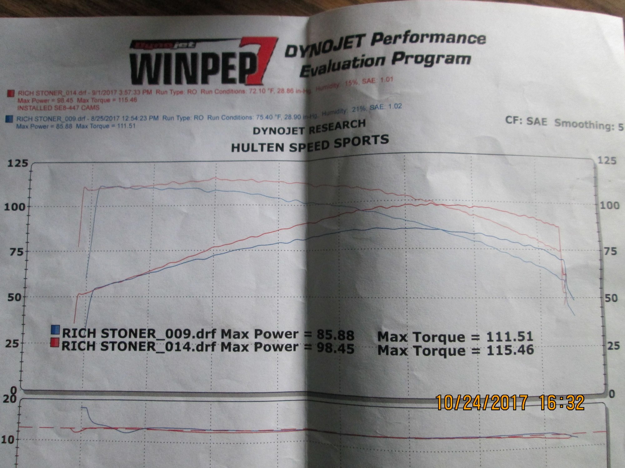

Default 2017 CVO Limited 114"

This was my 2014 CVO Limited, blue is stage 1 and red is stage 2 torque cam added. Stock intake and head pipe, S&S Grand National mufflers w/ DB killers.
