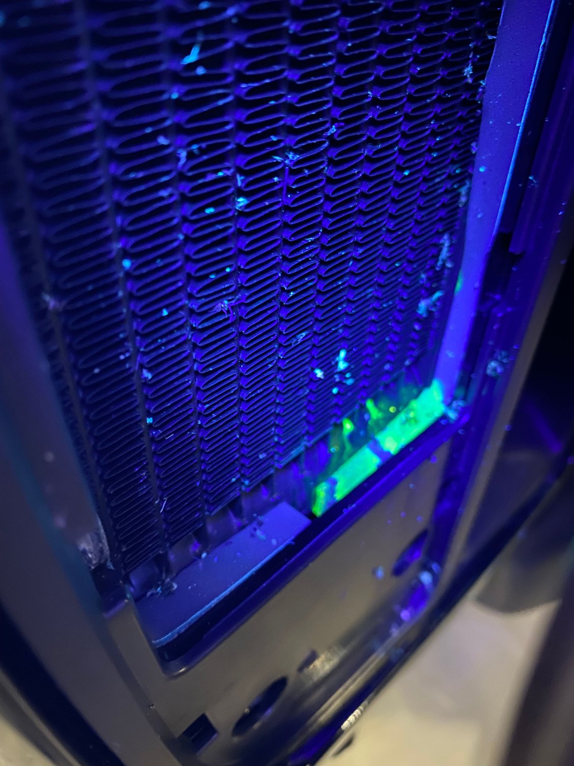

I trading in a 1999 Ultra Classic on a new 2021 Road Glide Limited. I drove it for about 900 miles and then did the 1000 mile service in preparation for a twelve day trip from Texas to Montana. Three days into the trip we were in Salida Co. and the bike developed a leaking radiator. The next morning I drove to Pueblo to the Harley Dealership to see about getting it repaired. Not only did the dealership not have a replacement, there were none to be found in the state of Colorado. On top of that, the radiator is on Back Order from Harley Davidson. Without a replacement, I limped the bike back home to Montgomery Texas filling the cooling system as need be. So here I sit with a brand new bike that I cannot ride because the radiators are on backorder. Harley, you got to do a better job on replacement parts.

Damn, that's some bright *** green!! Folks loose ther cooling systems all the time, pumps mostly. You only cool the exhaust ports on the heads, not the whole engine that's water cooled. I'd have no issues running it while waiting on parts, not going to leave you stranded. Still sucks tho!

well for starters, twin cooled models don't have oil coolers, because they chose to rely on liquid cooling instead..then there's the sensors, and protection modes they trigger and the fact they state if the cooling system fails you should only go a certain low speed for a few miles..among other things...I wouldn't do it, but you could always try it and let folks know how it worked out

You should talk to your dealer. The water cooled heads are for Rider comfort while sitting at a light or in slow traffic.not for engine longevity. If the water pump fails or the radiator leaks it runs just like an air-cooled Harley because it is an air-cooled Harley. Know what you're talking about before you give a guy advice. You should still get it fixed as soon as possible but there won't be a problem riding it home.

Rather than wait for an HD replacement, remove the radiator and take it to a radiator shop and have it repaired. No you shouldn't have to, but at least you can then enjoy your new bike.
