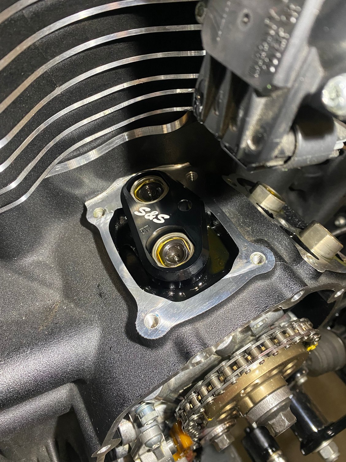

Before deciding to go stage 2, I was at stage I with the HD Ventilator Air Cleaner and Khrome Werks HP-Plus 4.50 mufflers. Tuner is of course the HD SE Pro Tuner. The dealer that built my bike did that work. Through Fuel Moto I'm going with their Jackpot 2-1-2 Stainless Head Pipe. I've heard both opinions on change/don't change head pipes, and I felt like a stage 2 with the stock headers would have me always thinking I'd left TQ and HP on the table. I'll be keeping the Ventilator AC as Fuel Moto said it was excellent and any gains from changing to another AC would be very minimal for my setup. Wood 22XE cam, Wood lifters, FM adjustable push rods. I'm adding a set of the S&S Billet Tappet Cuffs to replace the stock HD plastic pieces. FM straight up told me to keep my KW mufflers, which now have the KW Torque Monster Inserts in them. I'm counting on the big 4.5 pipes and those db-reducing inserts to balance out the increased volume of the no-cat head pipe. Finally, FM assured me they had a spot-on map for the Power Vision Dyno Jet tuner and my overall specs, including RDRS. There was zero hesitancy from Bob at Fuel Moto and I came away from the conversation feeling extremely confident. The package price of the items below, plus the head pipe (not shown) came to just over $1800 with shipping.
Everyone has their own preferences and methods. All I could suggest to you (based on my very limited experience) is to contact a well known and trusted engine builder or tuner for your questions. I could not be more pleased with or trusting of a company than Fuel Moto. I believe your Street Cannons are very good and I see no reason not to keep them.
