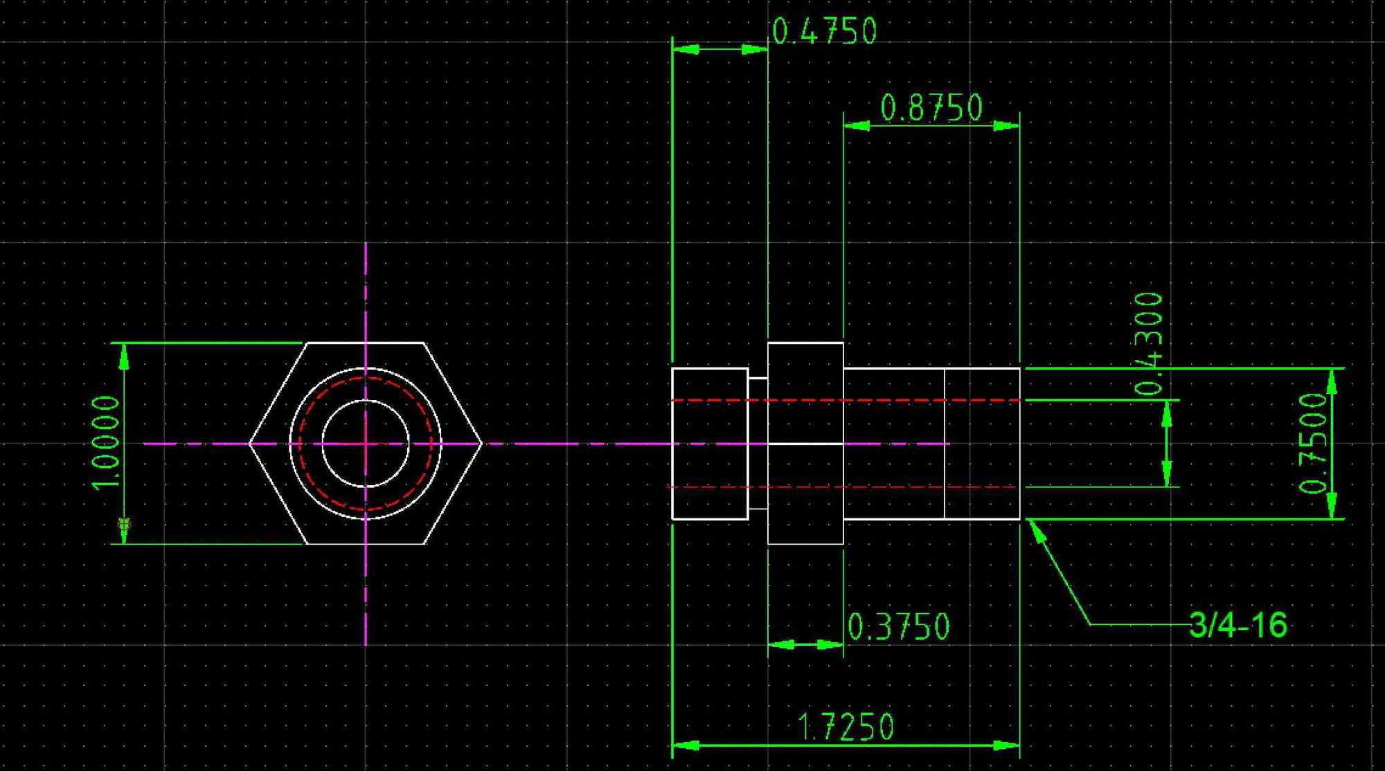

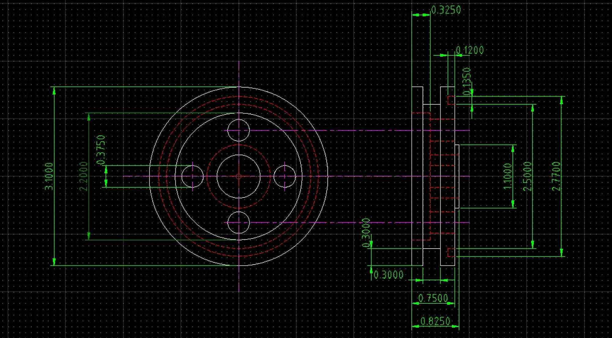

As written in the title. I got tired of spilling oil when changing the filter.. Don't know if this will work but I extended the filter a little so can install a drip catch that should trap all the oil. It extends the filter some and adds a groove that a filter drain can hook into to keep the oil from dribbling.. Will have to wait for the next oil change to see if it works..

For those who want to make one.. Some dimensions are missing but you should be able to figure them out...

O ring is a 230. Needs to be Viton.
https://www.mcmaster.com/catalog/128/3869
