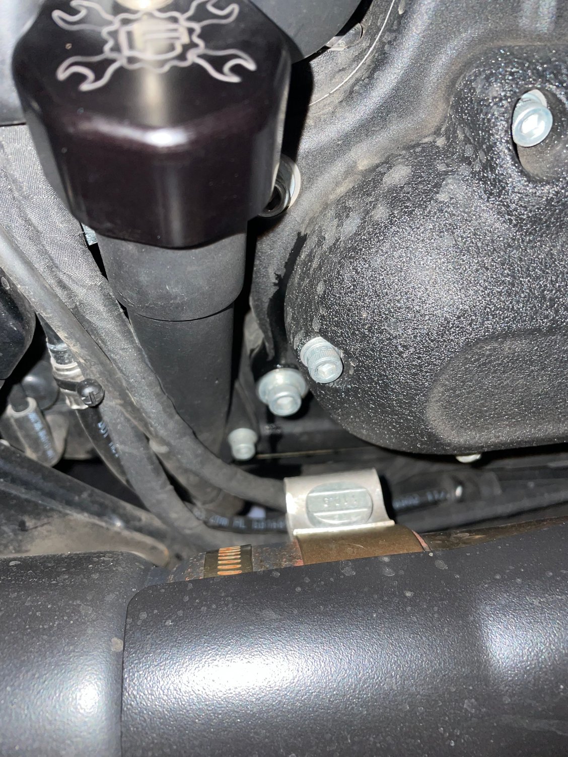

Evening all.
I’m hoping someone can tell me what’s going on with my bike.
Tonight I was doing a little testing, changing out baffle inserts, riding for 10 minutes calmly. Doing a pull up to 80 then riding again calmly for a further 5.
I did this twice. Outside temp was 60f
As I was coming back home after the second test, I was joining the off ramp when my engine lost all power and cut out. I pulled the clutch in and coasted to a safe place.
The engine management light and oil light were on. I looked under the bike and could see a few drops of oil which I assumed was coming from the vented dipstick.
I left it 5 minutes, started the bike up like normal and got home without any issues.

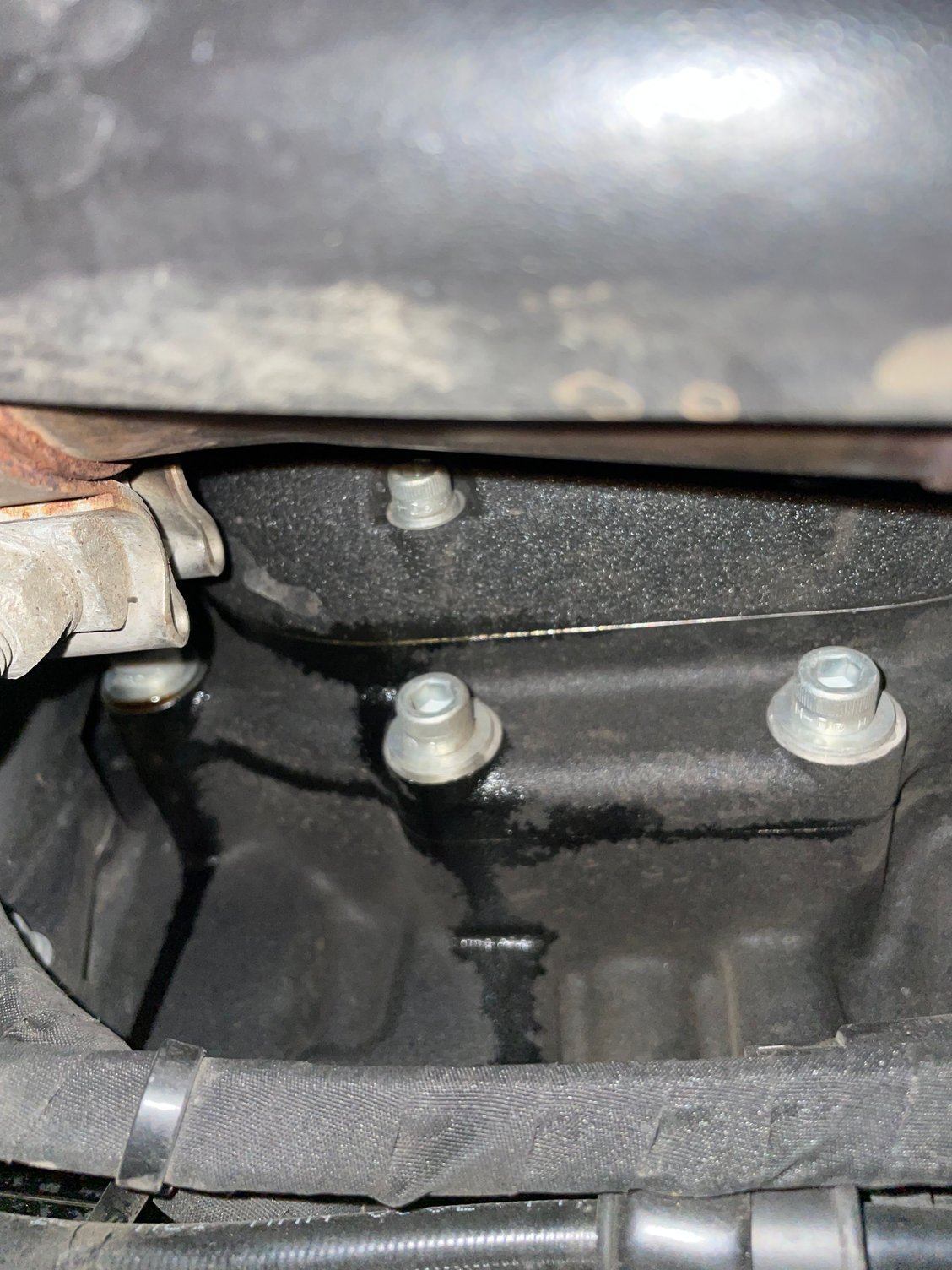

I inspected the bike when I got back and could see that the oil is coming from the dipstick that I have vented to atmosphere but is also coming from the casing.
When the ignition is on these lights are still displayed but turn off when I start the engine.
Please could someone shine some light on this?
Thank you in advance!

Any idea what the oil leak from the transmission cover could be? Pressure build up forcing its way out, maybe?
