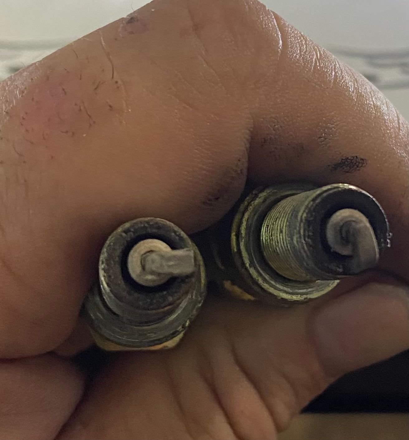

Originally Posted by flh canuck
Those plugs look like they have a few miles on them and are overdue for replacement. A dyno tune performed by an experienced tech will be the best money you ever spent and should increase both fuel mileage and performance from where you are presently at.
The plugs aren’t that old maybe 10,000 miles give or take.
Old Aug 22, 2022 | 12:42 PM
mjwebb's Avatar
mjwebb
Joined: Jan 2008
Posts: 13,672
Likes: 11,459
From: State of Confusion
have you checked for any codes in the DTC menu, maybe an 02 sensor or something acting up..I'm just using that as an example of a wild @$$ guess..try posting this problem in the forum where the real experts reside..
https://www.hdforums.com/forum/ignit...-injection-55/
yes I have checked for codes, there are no codes. But I did notice that when the bike is not running one of the o2 sensors was reading 5.10 volts, but with the bike running it seemed to be the same as the other one. I will try posting in the other section. Thanks.

To my eyes, the two pics in original post look identical to one another…
I think your right. How the hell did I do that🙄
I will try and get the right pics in there.

Here are the right pics.
Front
Rear
