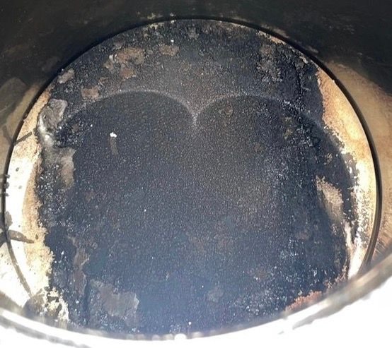

Never considered the breather bypass for my `19 FLHT, until I looked at the pistons during a teardown at 11,500 miles (I had to split the cases to look for debris after a cam bearing came out in pieces).
so you can’t believe lack of breather bypass is the root cause of excessive carbon build up, rather an underlying problem existed that adding a catch can is attempting to mitigate the impact. I had 5 times as many miles with a lot less carbon and believe my engine to be operating properly as designed

No, there is no underlying problem, the engine did not use any noticeable amount of oil before I tore it down and does not use any oil now.
I think I have the simple engine diagnostic stuff down after 48 years as an aircraft mechanic.
Before I rerouted the breather hoses, I would find oil around the air cleaner, and on the breather hose.
Since I rerouted the breather, I find no oil on the end of the open breather hose (no catch can is used).
