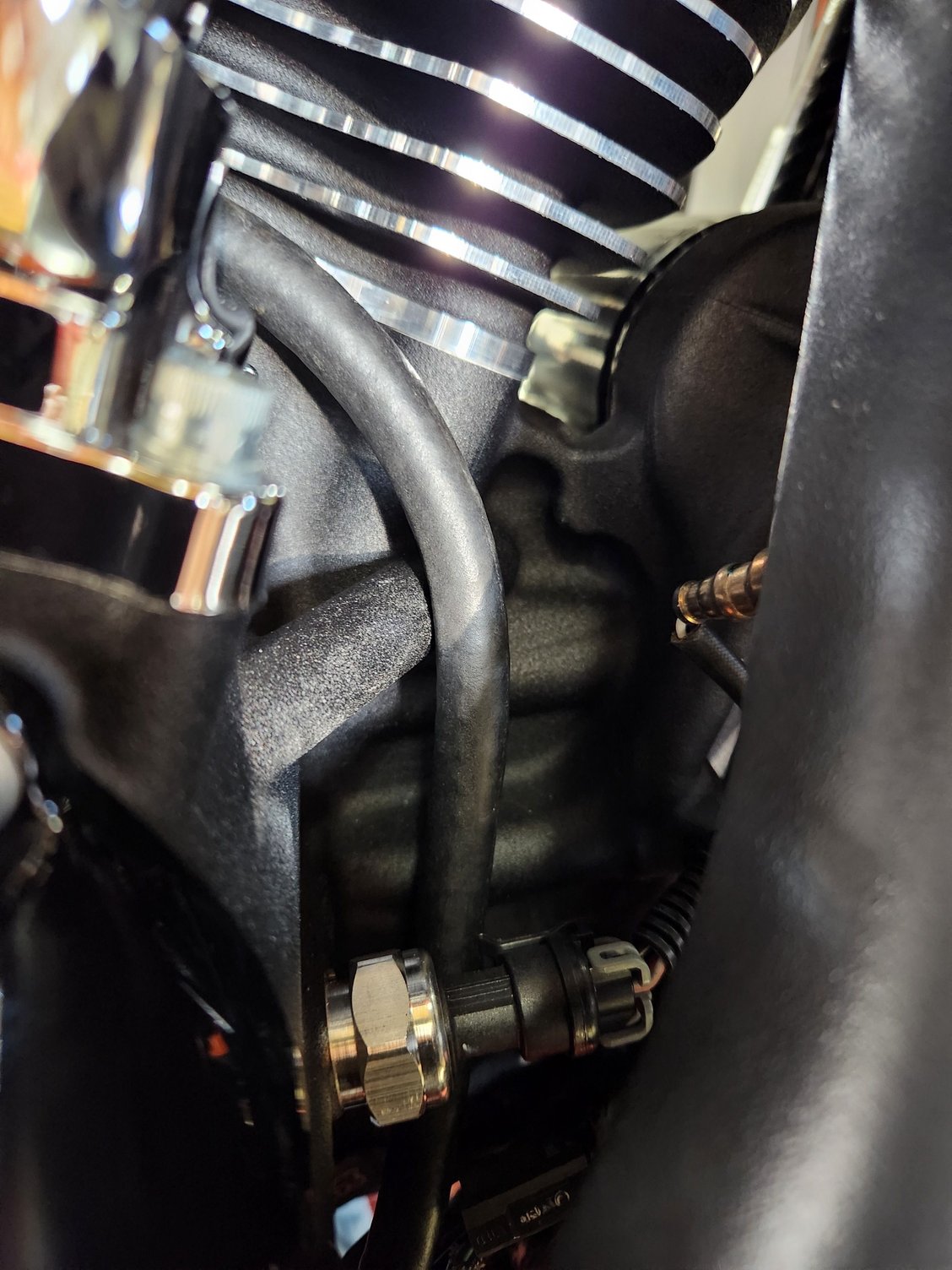

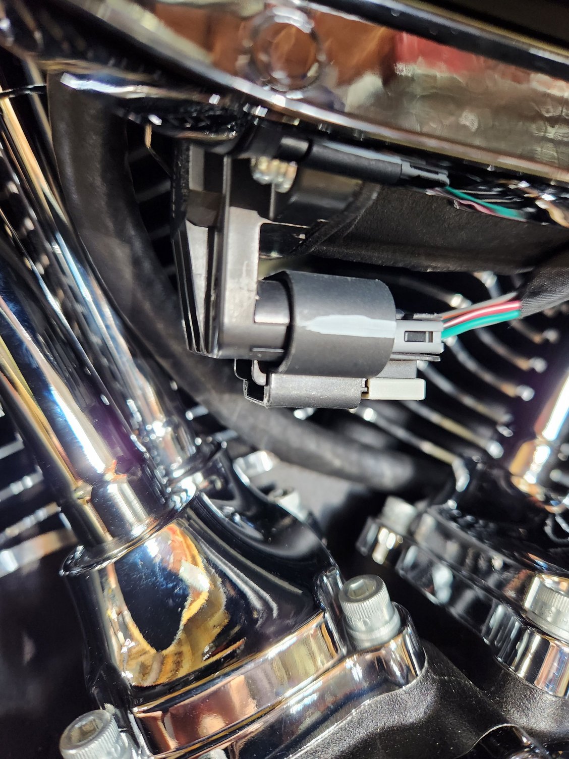

Anyone have a idea how hot the base of the outside cylinder jugs can get? Trying to figure routing of my external breather hose. Stopped yesterday at Colllifower and they had some heat resistant hose and wanted to know the temperature to see if I should use that or would regular hose work. Trying to keep it tucked out of site as much as possible

Old Dec 18, 2022 | 09:26 AM
Diesel X's Avatar
Diesel X
Joined: Oct 2020
Posts: 289
Likes: 508
Just in mock up phase. Plastic tee will be replaced with brass 90 degree. Notice the hose routing. Placement is why I asked about temperature. Just trying to keep it out of sight as much as possible
