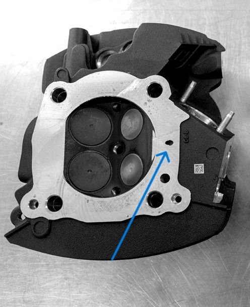

I have the same thing on my 2017 RGS. If you fold up a paper shop towel and stuff it between the fins where the head and cylinder join, ride the bike to see if there is oil on the towel. If there is then you have leak from the casting hole that the head gasket is suppose to seal. S&S makes an expansion plug kit to plug this casting hole (pt #.910-0677). I believe it is required for a 124" kit. When you replace the head gasket I would recommend plugging the casting hole to prevent this from reoccurring.
This picture shows the casting hole on an M8 oil cooled head. That is where the oil is coming from.
Great idea...I will do that. Should confirm the head gasket. As far as the casting hole....so dumb....I know why its done but could be done with a considerably smaller vent hole.
If it is fact the head gasket im going with the S&S 129" cylinders and pistons.
