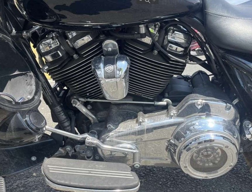

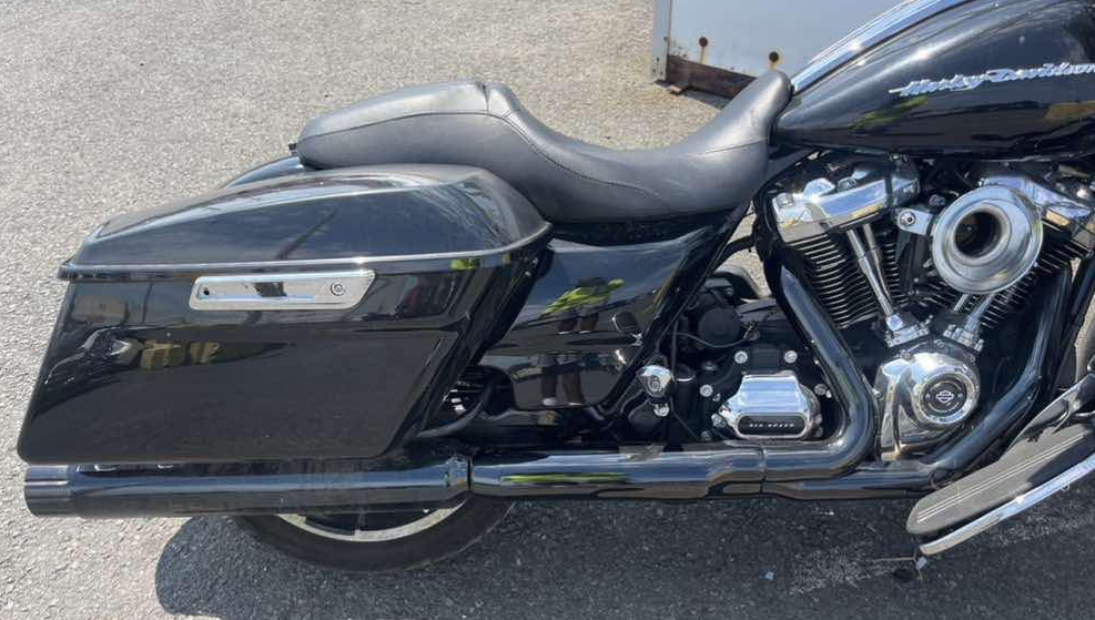

Just bought 20’ fltrx from auction. So no history or other info about bike comes together.
Wondering if there is a way to find out whats the build/modifications without physical disassemble it?
From photos it seems that something was done here.

Can’t really tell much from outside.. that AC might be aftermarket but looks incomplete anyway. Exhaust looks aftermarket but can’t tell. Anything under the covers(cam, rocker box, etc) you won’t be able to tell without taking off.
On the primary side it has a clear derby cover and under it looks like an aftermarket variable pressure plate for the clutch , can’t tell which brand though from the limited pictures

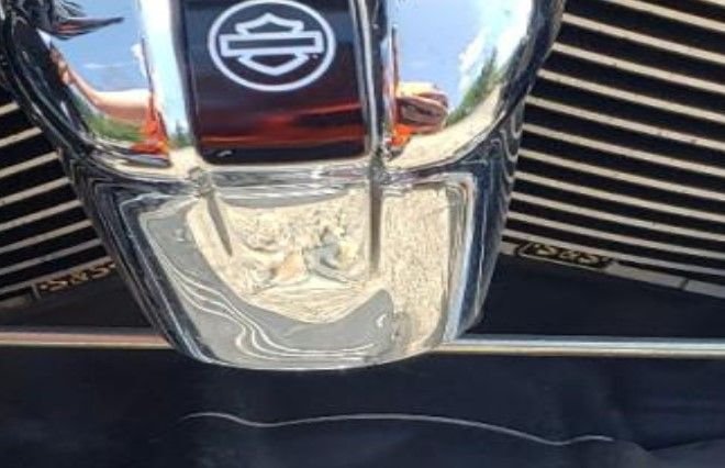

It has a big bore kit
i am not very familiar with big bore kits. so it should be at least 124' as far as i can find?
pistons + cylinder is the minimum what i should look for? or it comes with something more in the kit as minimal?
You can assume the original engine was 107”, so yes it is likely a 124” kit.
without going into the cam chest, you can only guess which cam is in it.
We have no idea about anything else. Speculating will get you nowhere.
Either dig into the previous owner, or tear into it to see what is there.

With the cylinder kit, slipons and open style air cleaner, it would require a tune based on those modifications. Can't tell much about the exhaust except it looks like an OEM herader but was it de-catted? But to get specific, you would need either the documentation from the work or some disassembly is required.
Would have been nice if it came with the tuner.
