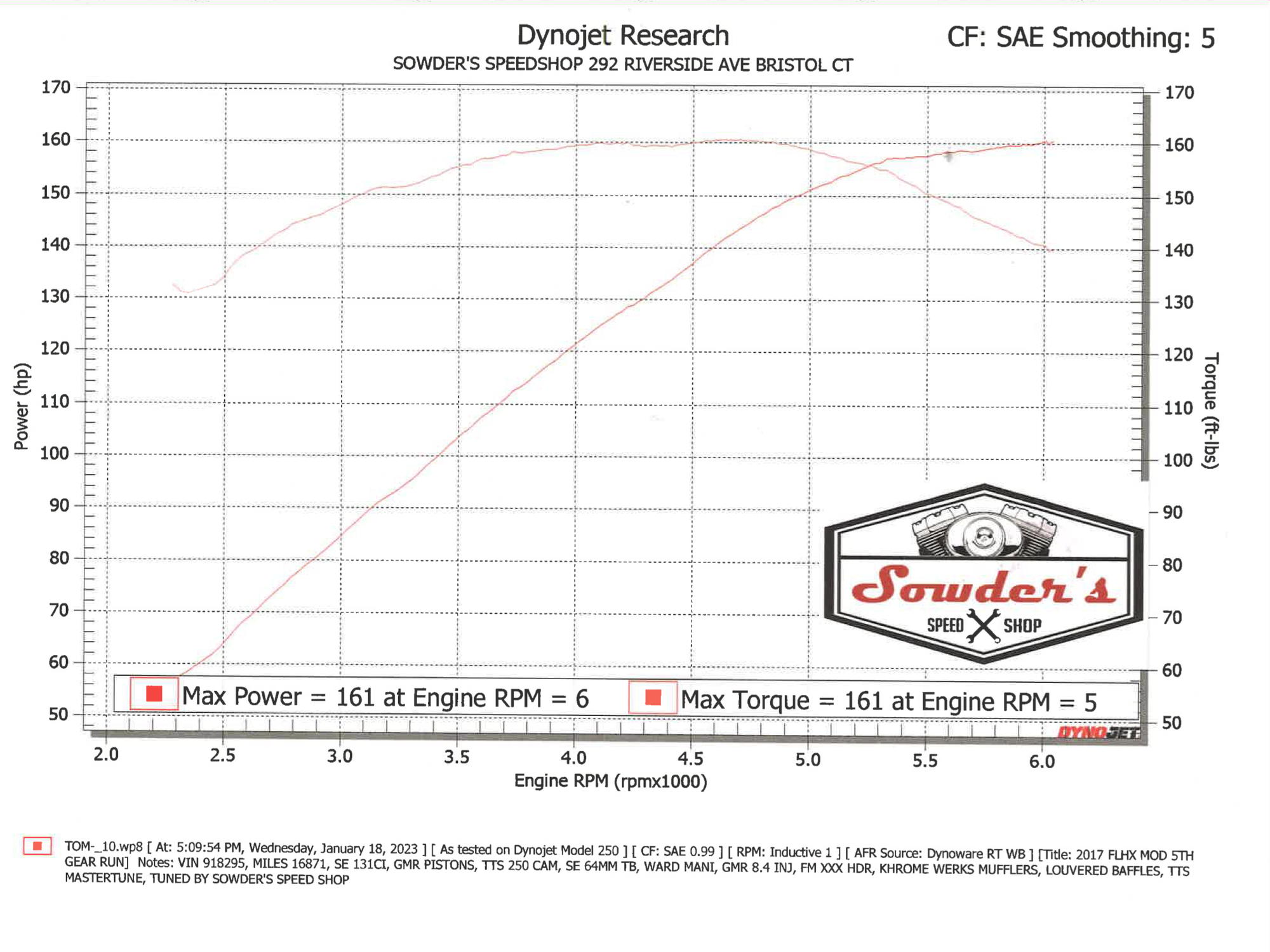

The TTS 250 cam works well.
I saw this build on the internet and modified my 131” with similar results.
