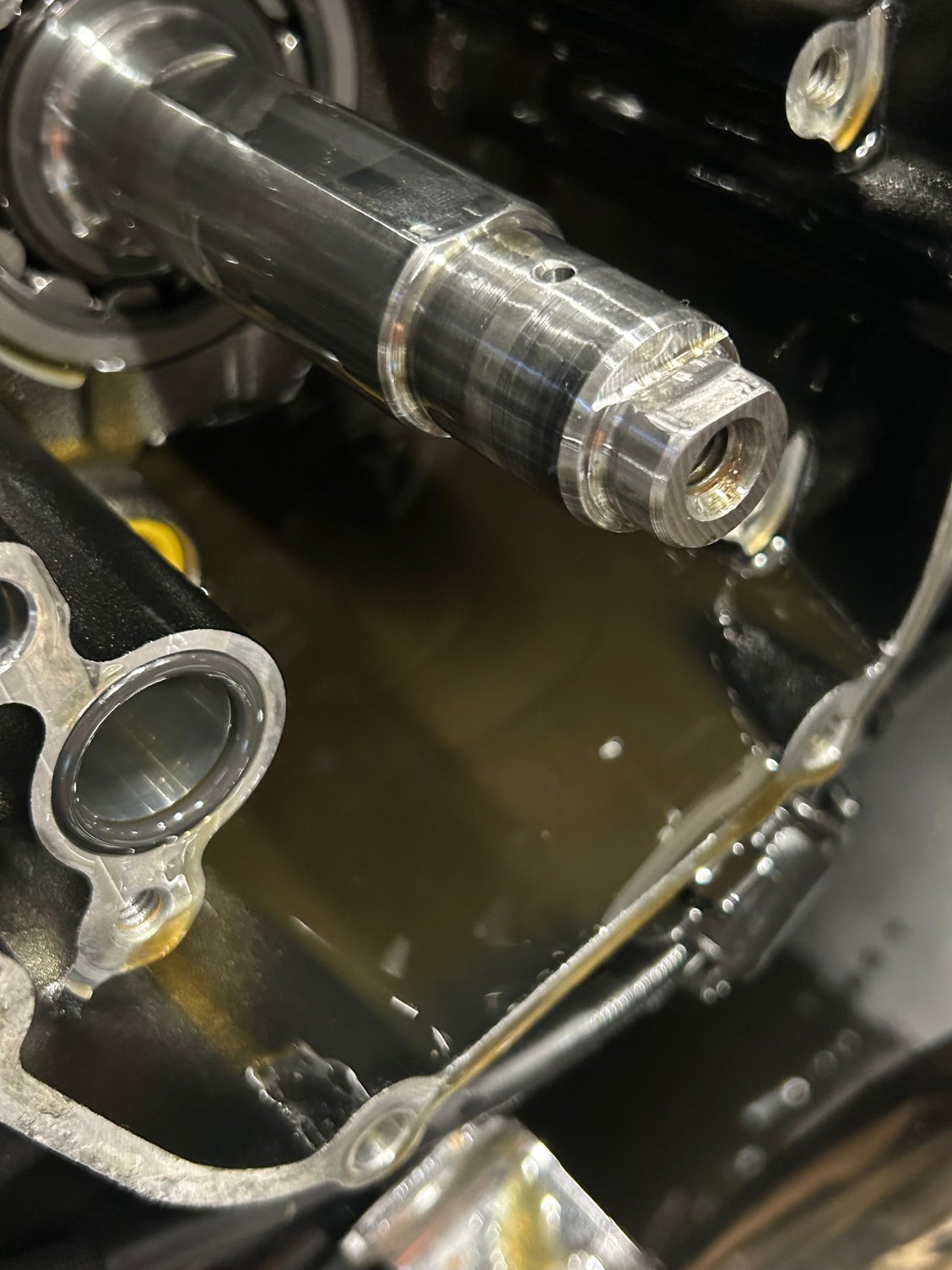

You need to remove the oil pump from the cam plate and check the bushing on the cover for wear. But crank runout is the thing you need to know first.
Paul

Thanks for the help below is a photo of the cam plate crank hole has some witness marks but doesn’t feel too rough. Is this normal?
I have a new dial indicator coming tomorrow morning to measure run out.
