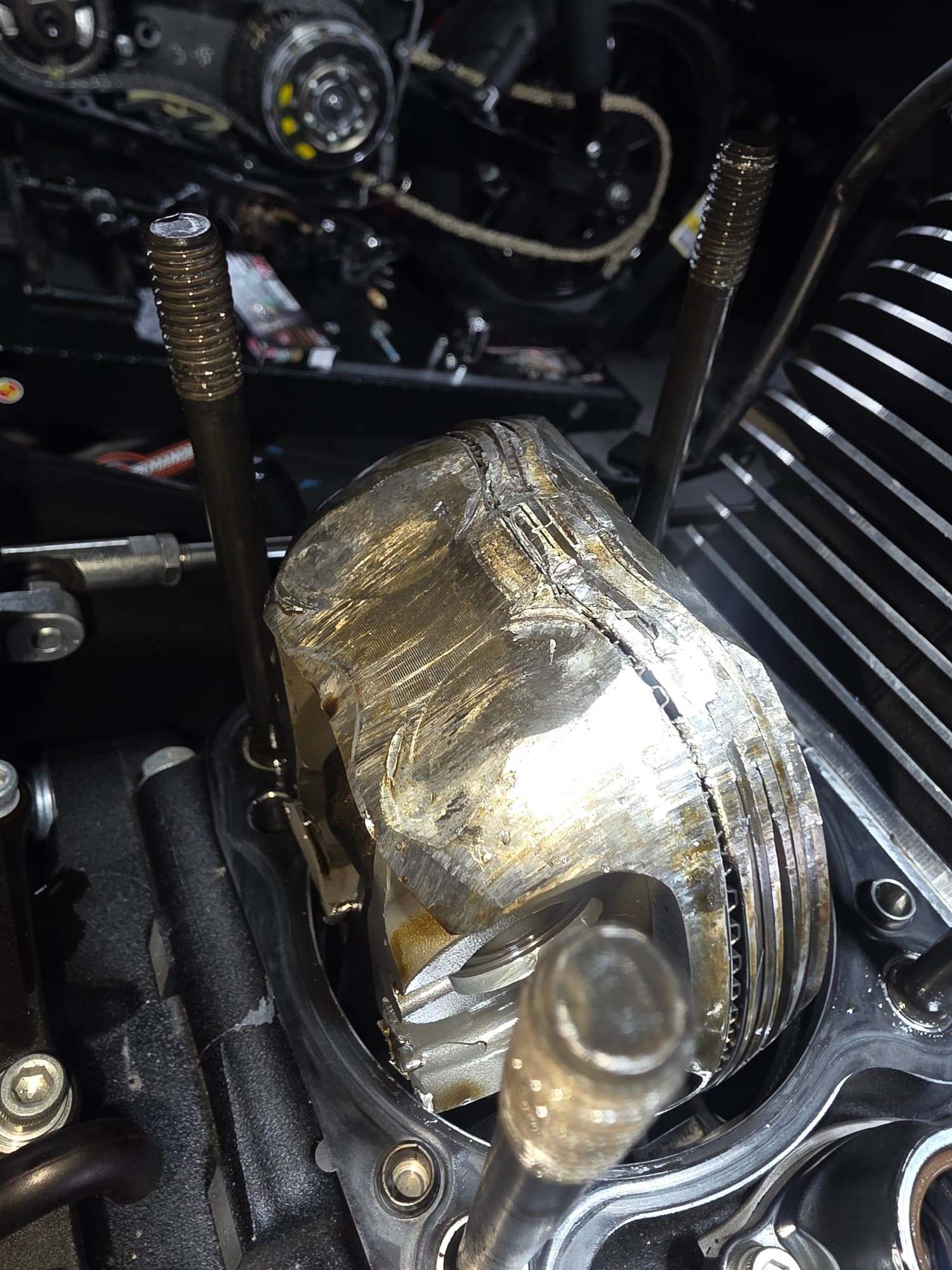

Hi here are some pictures of my 131 Stage 4 . Catastrophic Failure after 8300Km approx 4000miles down under in Australia.
Anyone with any thoughts on the reason, it happened interstate and the Tech repairing it says the Tune was Crappy and long days sitting on cruise control have exposed the Engine to Lean Cells in the Tune for extended periods causing overheating and seizure of rear cylinder and the front cylinder wasn't far of grabbing either. Back home my normal riding is twisty hills and constantly on/off the throttle.

I had the 131 stage 4 with a Powervision tuner and never had a issue except using my right hand heavy it was the fastest HD I’ve owned
