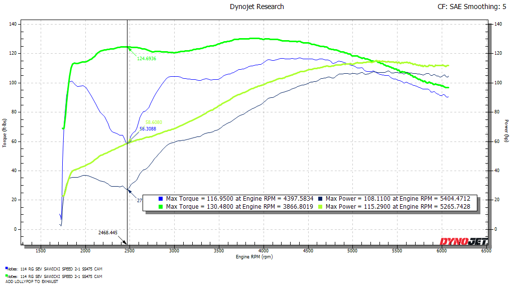

I'd try a lollypop in the exhaust before I spent the $ on a new cam and tune. The S&S 475 is extremely exhaust sensitive. This was with a Sawiki Speed 2-1, very open. We added a lollypop (DK customs sells a pre made one) and it was night/day difference in feel & performance.

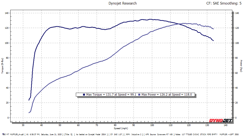

Earlier this year you shared a chart with me of a Gen 2 Softail that had a TTS 185 cam and a Tab muffler with the performance baffle. Do you think a lollipop would have helped the low end torque on that bike and maybe resulted in additional horsepower?

Yes, but that bike was traded before further testing could be done.
