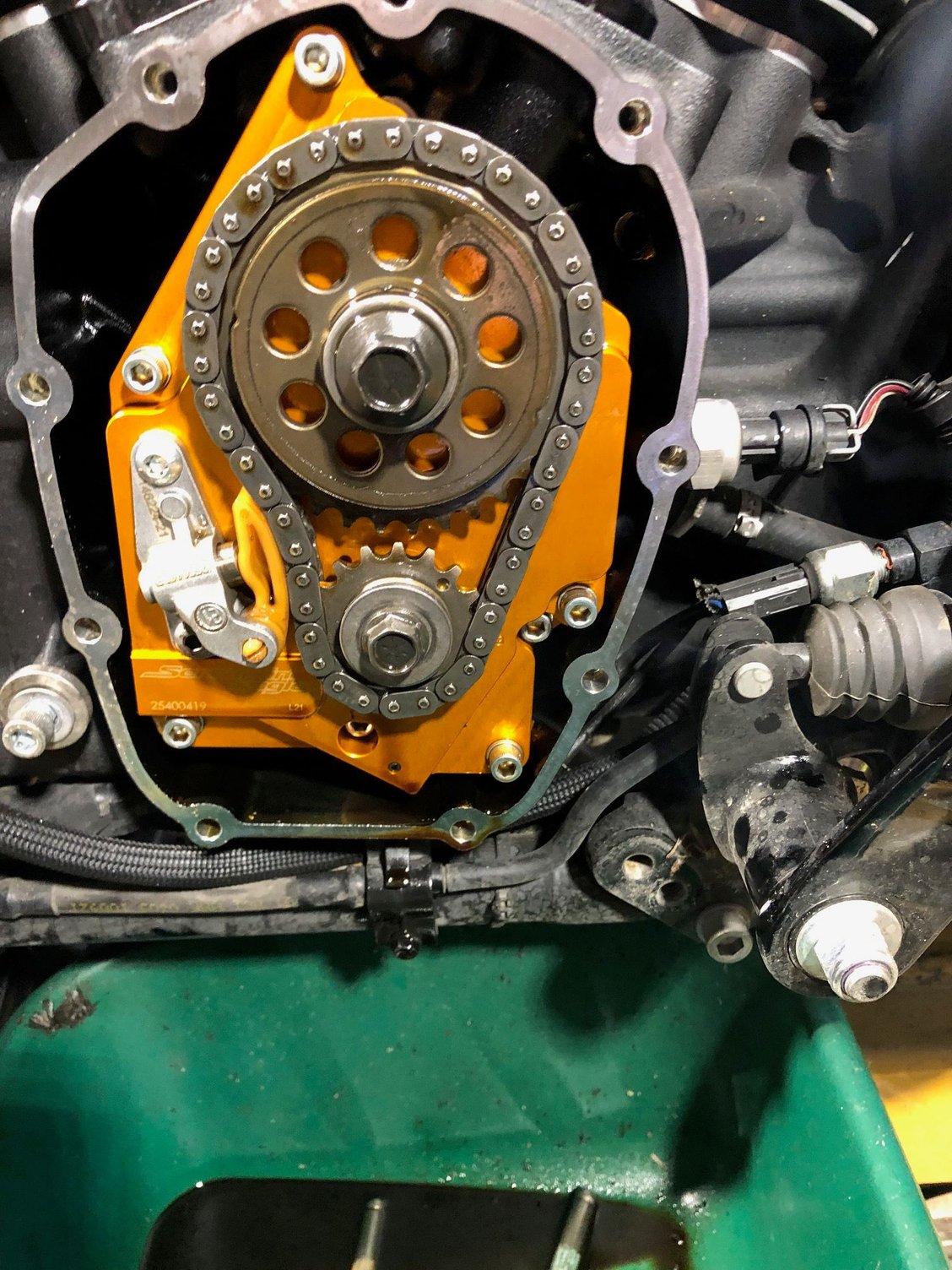

OK, I got her all torn down. I still had the original oil pump, ordered the latest revision, two week delivery.TDC Question-photo457.jpg

The original sprocket retention kit Part No. 25566-06 is still called out in the online parts manual, but...
There is an updated sprocket retention kit available: Part No.91800088
Link to Service Bulletin
