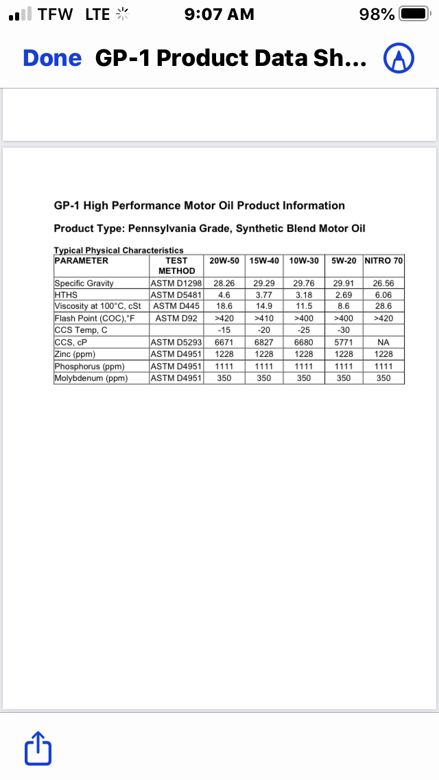

Default GP-1 Oil
Here is the info on Driven oil
Mobil 1, 15W-50 motor oil, available via 5-quart jugs at Walmart, less than $6 per quart, many times a rebate is available
Flash Point: 449 F
Zinc: 1300, PPM
Phosphorus: 1200, PPM
Flash Point: 449 F
Zinc: 1300, PPM
How much Moly?
How much Moly?
I don't know. Didn't see any product data sheet that listed that information. How much does one need?
