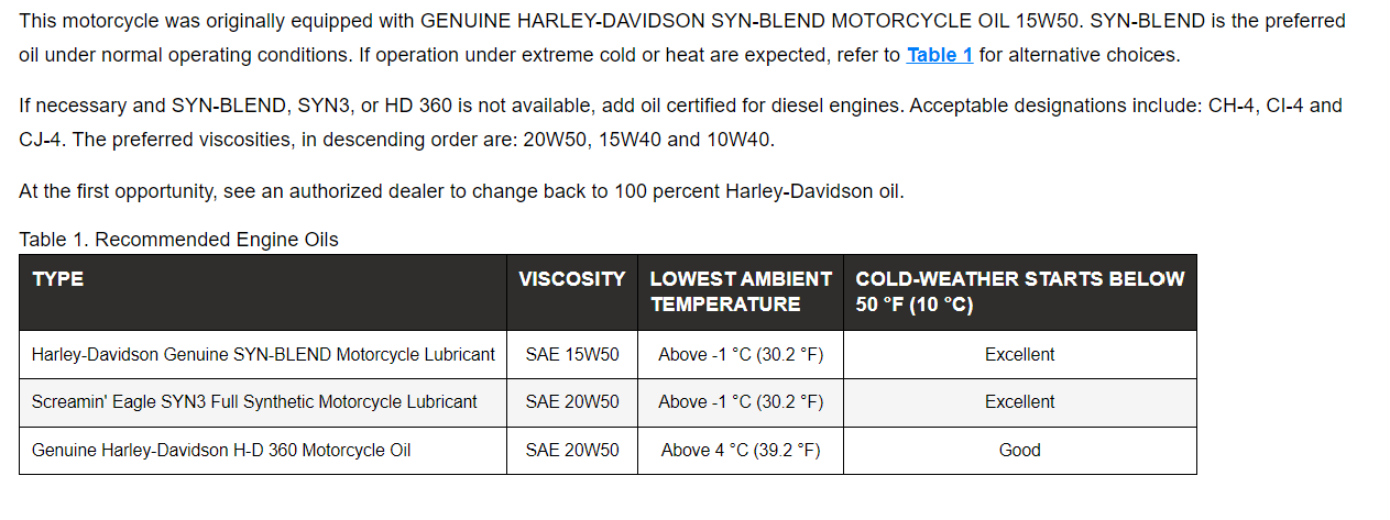

Originally Posted by tvon
Not to derail this topic, but HD does not recommend full syn in the PA engines. Semi-Syn 15w50 is what HD says should only be used.
Reference for the above statement please.
The owner's manual specifically lists semi-syn 15W50 and full syn 20W50 as "recommended oils" with excellent cold weather starting capabilities. The new full syn 15W50 oil that is coming out is backwards compatible with all engines that use full syn 20W50.
This isnt an oil thread but i will point out what is in the service manual:
That table is exactly what I was talking about. It specifically lists Syn3 full synthetic 20W50 as a "recommended oil." Nowhere does it state that full synthetic oil is NOT recommended for the PanAm (which is what you stated in your original post).
