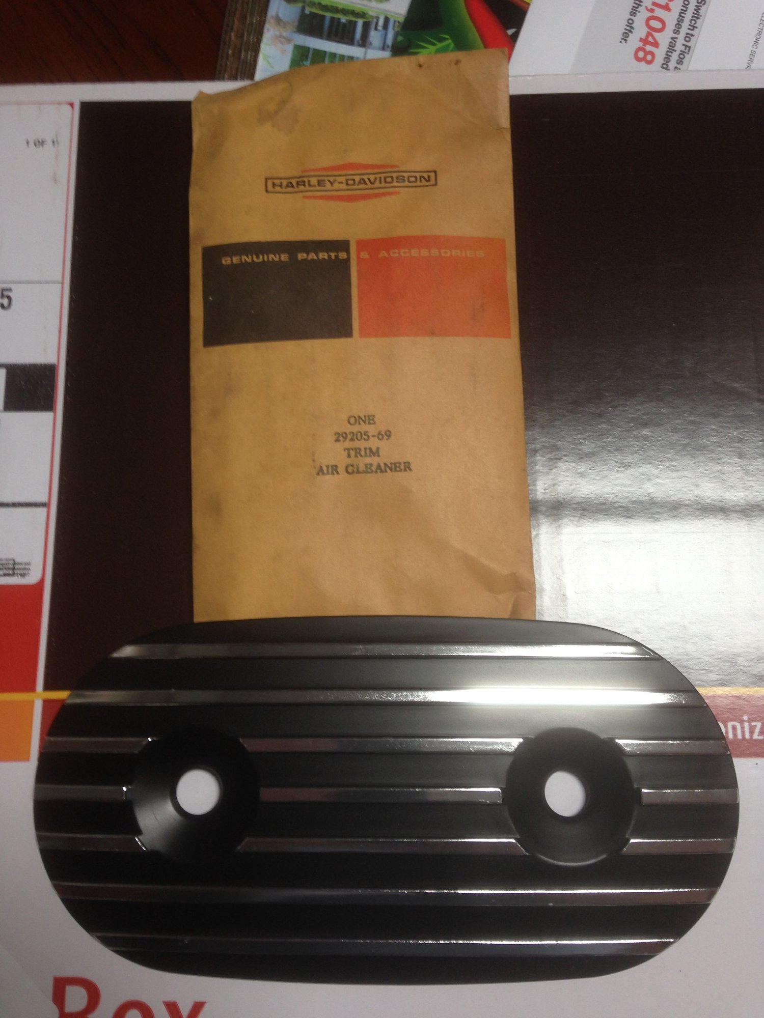

And then the matching air cleaner insert, but I am sure you are not running this cover, but that would give you the complete 3 piece set:
Nice, very nice. But yes you are correct. I am running my stock Linkert with the stainless cover
