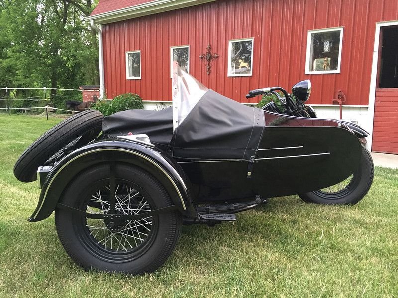

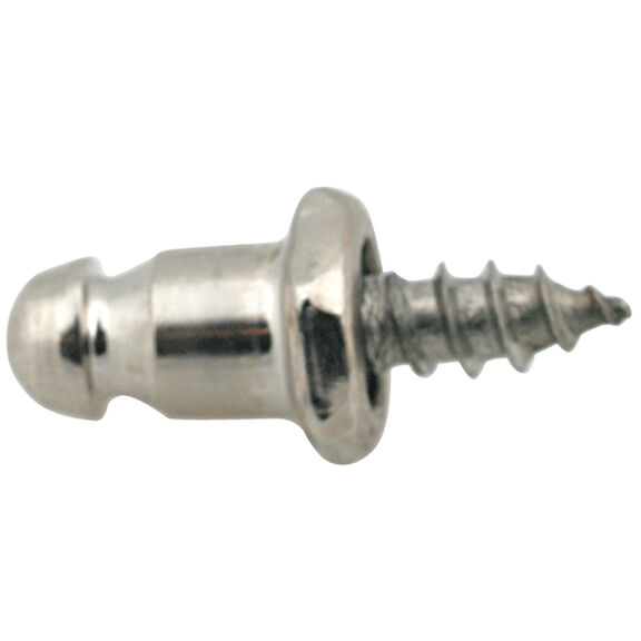

Can someone please tell what this called. I lost one and need to replace it.
It keeps the cover in place.
Used to have them on my MG
https://www.minimania.com/part/TFP10...Sprite--Midget
https://mossmotors.com/226-408-stud-...RoCSJMQAvD_BwE

Hard to tell without them side by side but looks like a typical canvas attach.
Try a marine canvas shop or supplier.
May not be as easy as I thought. Now I remember the marine stuff usually has a wood screw for attachment and not a small bolt.
Eyelet Stud with 8 X 3/8

that thread may unscrew from the cap

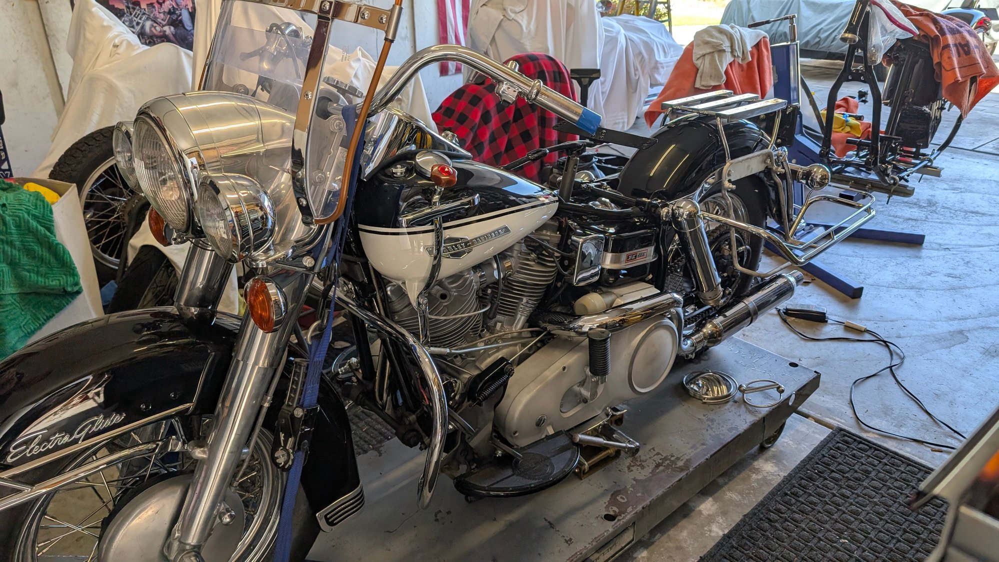

Been a while since I posted any progress on the 65. Good news is that I got it running. Have a steady leak from the cam cover oil passage bolt with the engine running. It is as tight as I can get it. Has the brass washer behind it as required. Can't find the washers themselves so I had to order the bolt and washer from Colony. I'll compare the two when I get the new one. Of course I am open to recommendations for solving this another way if anyone has some suggestions.
Generator light was staying on with the motor running. Tested the relay and it was DOA. Fortunately had another OEM as a back up, so that should solve that issue. Rookie mistake. Should have tested it before doing the install. I zeroed in on the relay immediately because I had the generator rebuilt and the relay was new to the rebuild (didn't have one on the bike before the rebuild).

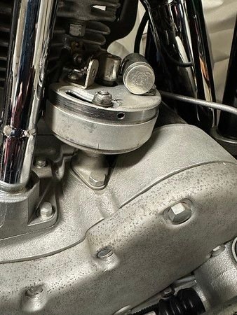

Bike cranks too long before starting when cold. No intake manifold leaks. Not a smooth idle either. Had a shop rebuild the bottom end and they also rebuilt and installed the timer. Pulled the cover and this is what I am looking at.
So while the timing mark on the sides are aligned, it sure doesn't seem there is a lot in the way of adjustment for the circuit breaker base assembly.? Shouldn't it be more centered? Think I may have to call on Twizted to assist in this. And since I have found some sipping whiskey he enjoys, I may be able to lure him down

As long as the point gap is good and the timing correct where the slot is don't matter.

I'm going to sneak in on this, was over to Dave's today to play with the 65 a bit, pictures do not do that bike justice. The man takes building these things correctly very seriously. We got it fired up, tweaked a few things and she starts easy and idles nicely now. Little bait.

Max Headflow, thanks for the advice on the Carb start. Worked like a charm. And thanks for the visit from Twizted , fine tune was perfect (forgot to take some video).
Only bad was that it won't go into 3rd. Spent the rest of the day tearing $hit apart so that I can get at the transmission. First time I've rebuilt a transmission and it has done what it is supposed to do...shift thru all the gears but, then again, I haven't rebuilt a 3 +R since 1989. Once I get it out I'll pop the top. Dan suggested the shift drum may be one notch off. Guess we'll see. Part of me want to keep it, the other says dump it and just go back to the 4 speed. I recall John stating that the top end on a 3+ R is really bad.
