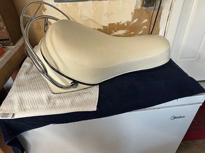

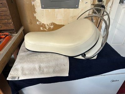

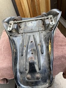

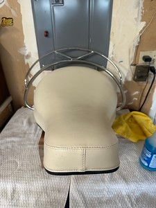

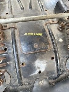

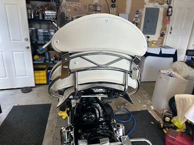

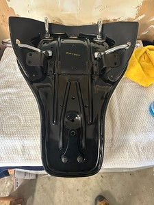

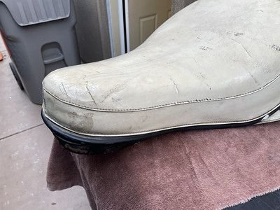

Some before and after of the seat
Seat mounted on bike with high and low backrest. Kinda gives new definition to the term 'go big or go home'.

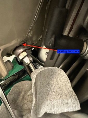

So I have a gas leak issue with the tanks. Tank shut off rod is properly aligned. I am using a peek seal tip on the rod bottom. I am using the copper crush washers top and bottom. Still getting leaks from the crossover line and the bottom of the tanks.
Need a fix please.

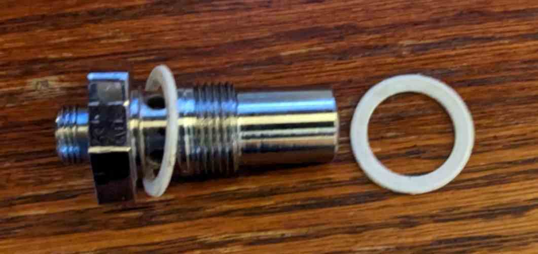

You can try annealing the copper washers as the were likely work hardened when stamped out..
I use Teflon washers that were made from 1/16 sheet.. You can't crank down on these like you can with the copper ones but for 1500 miles they don't leak. I also use one on the Linkert float bowel. Teflon is pretty soft but is very fuel resistant..

Looks like I am gonna have to give that a try. Teflon washers...homemade but you?
I made mine but McMaster has them..
https://www.mcmaster.com/95630A251/

"You can try annealing the copper washers as they were likely work hardened when stamped out."
Max Headflow, did just that. 12 hours now and still not leaking...finally...I hope. Not sure what is in the crush washers, but before turning bright red, they were on fire for a few.
