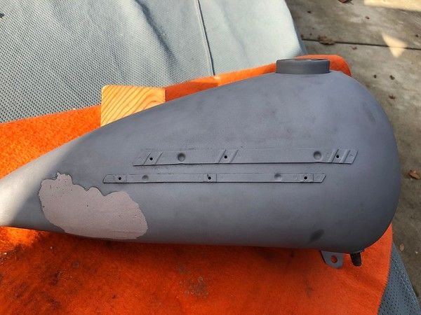

These are the 51-53 tanks that I had on the shelf since about 1990. Had them saved for a 58 motor in a 57 frame project that I sold to help out with my daughters college education.
I had always assumed that they were for foot shift model. Had my powdercoat guy strip the paint off and after removing the bondo on the left tank with a propane torch, putty knife and stainless steel brush, I found this...
Left tank...

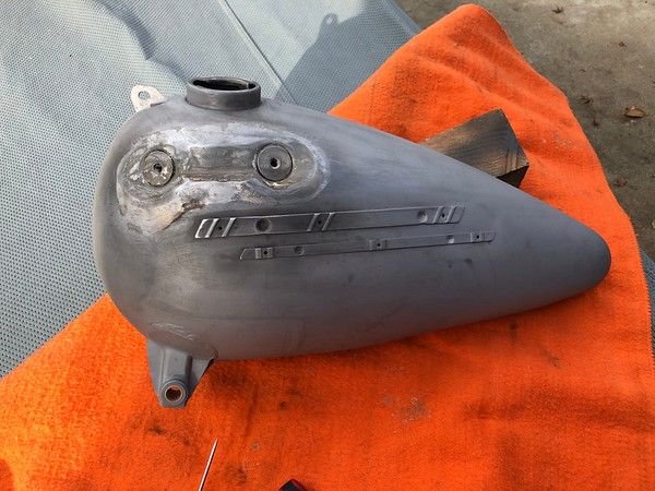

right tank...
repaired at some point in its life but no leaks
one tab rewelded...
Good job on the reweld. Sits flush against the frame tabs
Insides of tanks are really clean plus the emblems appear to be OEM as well (from the markings on them).
So worst case scenarios...paint them all black, chrome the emblems, and run them until I find a proper set of 3-1/2 gallon 63-65 tanks with a tank shift
