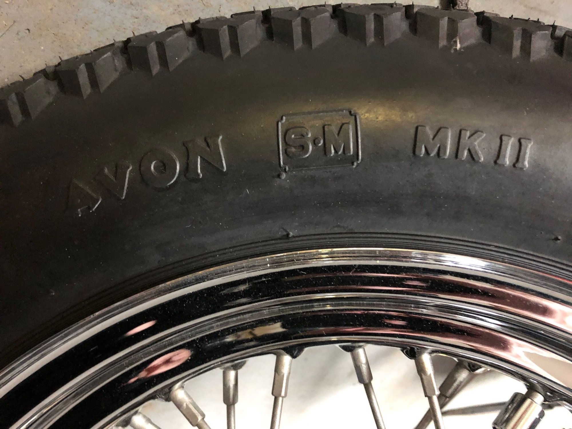

What's on my 66 and it had a set on it when I bought it but I chucked them due to age. I don't think my AVON's are going to unravel while cruising down the road at 50MPH. If Stinko can sell tires without killing people then I think you're safe on these. As for front and rear I don't know. You would think the rear takes more punishment than the front so logic would say its better than it needs to be on the front? Its not like the front has outstanding braking causing a sidewall failure.

forgot that dave - yes I talked to avon twice so I know they are giving the same info 2 different tech guys - said yes on the front usage
I bought maybe 50 of them last year from real collectables to knuckle / pan bobbers that went to LA from jersey as a bucket list thing
my shovel FLH I own i fell safe at 65MPH all day long and have run at 75 to beat the rain

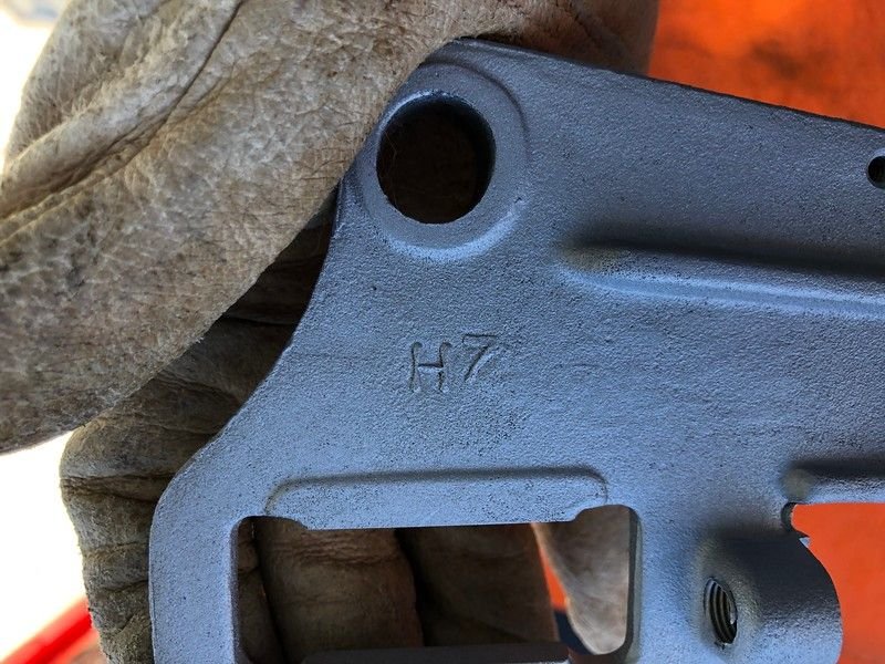

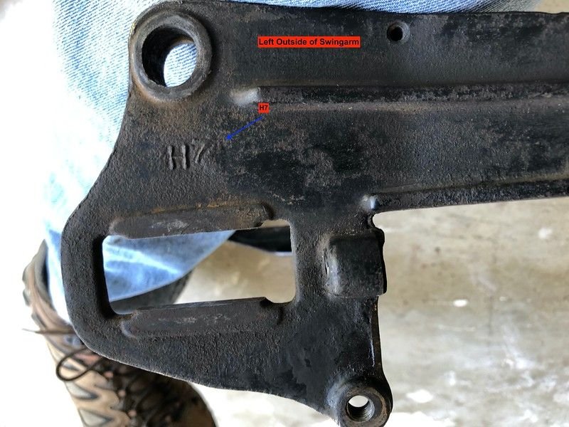

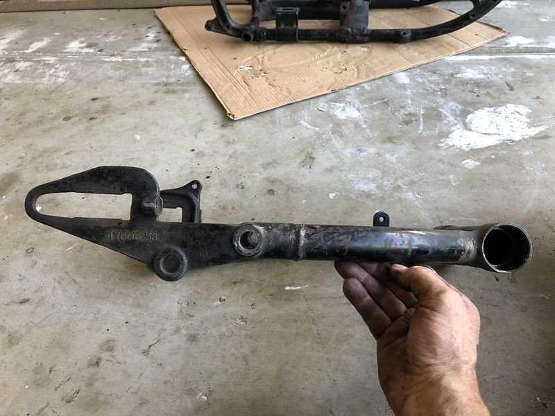

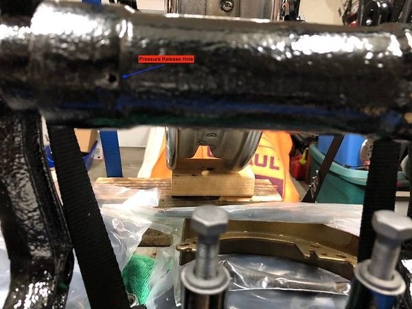

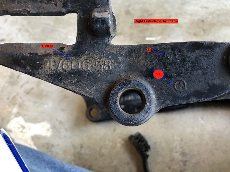

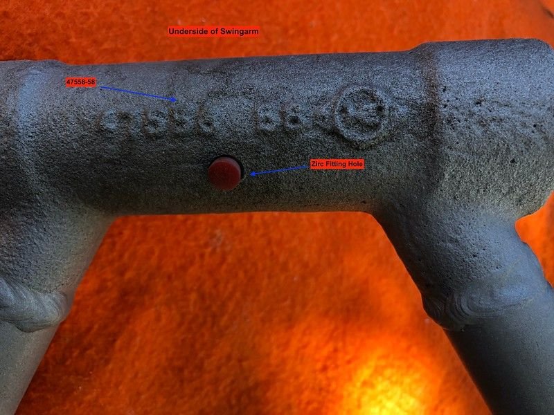

Swingarm identification & Markings
Right Side
Left Side

Your frame and arm are painted I assume and going back together?

Thanks for posting photos of the frame and swingarm. On the swingarm, forging number 47614-58A, left die number 8, run number H7 and R-H die number 33 are consistent with a 65 model although there can be some variation in the combination of numbers—for example, another swingarm I have photos of has the same forging number and left die number as yours but its other numbers are H4 and 27.
Another 65 model has H3 and 28 but the bike has a low SN.
Outside your R-H axle clip is hallmark Q with WF inside but I don’t know which company those letters represent.
Eric
