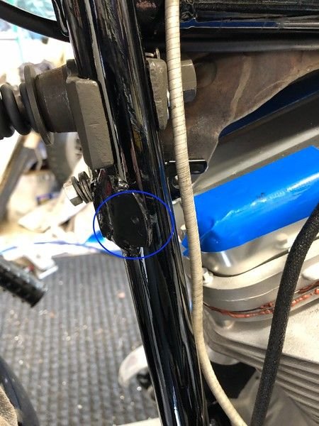

Need help identifying the clip that goes here and the part number and screww thread size please.
It is located on the left downtube.

Wasn't that where the clutch cable clamp was mounted to the frame? (At least I think it was that way on my 78FXE) The part numbers for the 78FXE should be
2585 - Screw 8-32x5/16 Pozidriv Pan head
7115 - Lockwasher No. 8 int tooth (looks like a star washer in the catalog
10059 - Clamp Clutch cable OR 38712-68 - Clamp, clutch cable (at frame front)

Thanks for the quick reply. Couldn't remember, but since I am going to use a tank shift and not my mousetrap (at least at thie juncture) it will not be needed. And I located the clamp and put it with my mousetrap set up.

Im pretty sure that tab is used for my timer cable on my 62. What did they repurpose it to in 65? 66 has no tab, seems like it wouldn't work for a mousetrap.

My '65 has that also. Unused. Does not look like it has anything to do with mousetrap. Prob left over from timer cable era as hellonewman says.

Yes looking at my pics of taking the bike apart, there is no need for it for use with the mousetrap assembly. But for some reason I have the screw and the clamp. I am thinking that maybe I used it to secure the speedo cable as it came down the left downtube. At any rate it will stay unused since the clamp holding the speedo cable at the top of the cases securely holds that cable in place.

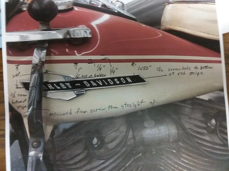

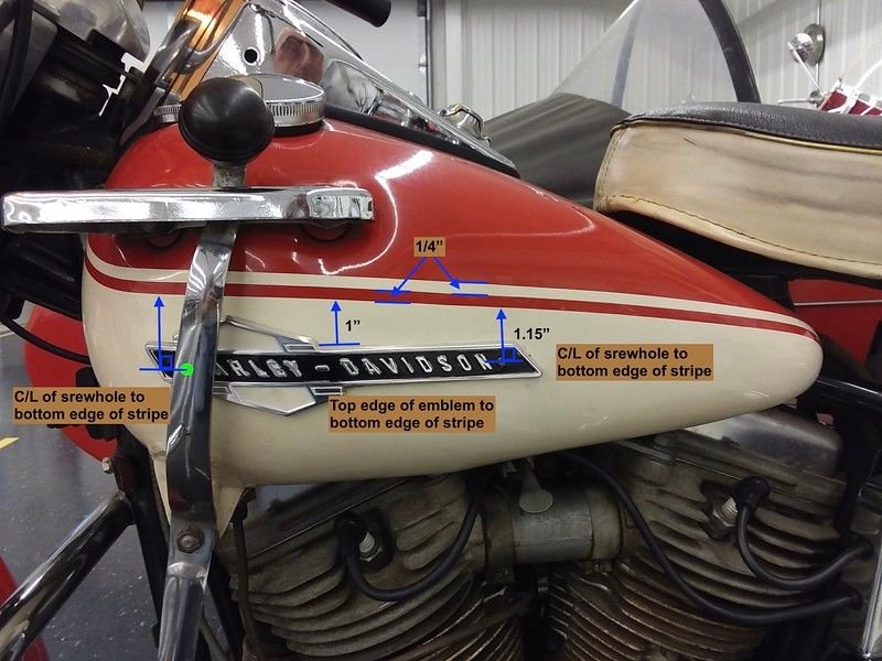

Measurements for painting 5 gallon tanks
From OP 65 FLH
And measurement for 3-1/2 gallon tanks (OP as well)
And another version of the 3-1/2 gallon tanks, just cleaned up a bit
