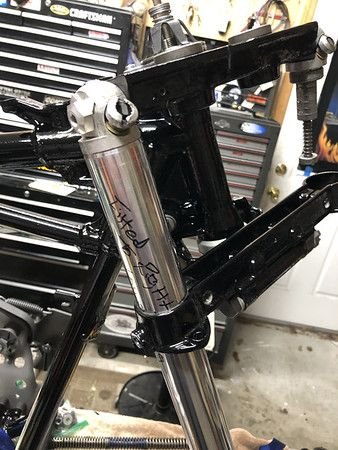

I need one shock rebuilt out of 4 at the very least, any suggestions on where to send them?
One step forward and twp stepsback today......
Assembled the rear shocks and put them on the top stud. Came back some two hours later...the right shock leaks. So....some wasted time amd money. Now I will have to use the 67 and up style until I find a correct one. Sucks cuz I spent the time and money on cad plating, spent the time and money on chrome, spent time and money sending them back east to have them checked, spent time assembling the shocks based on some person who said he "tested" them and they did not leak. Wrong!
Enough bitchin, whining and grousing.
To answer your question Paul. These shock are not rebuildable as they stand. They are completely sealed. They cannot be taken apart as they currently exist.I have found no one that can rebuild them.
I just don't understand why they are not built like the front forks with the plug and such that allows you to drain the oil in the forks and replace seals and such. I have an old set of Sporty shocks that are built in the same fashion as the Panhead shocks. I get done I am going to see about trying to modify them to accept a drain plug much like that used on our front end

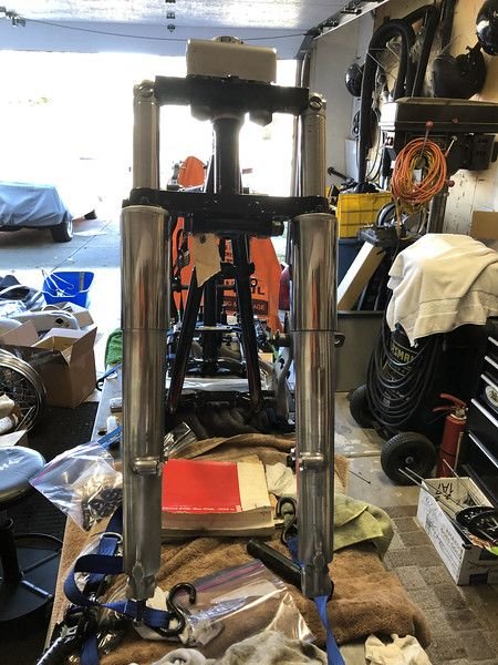

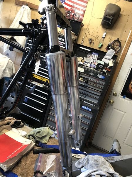

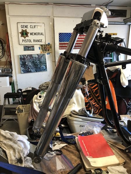

Top of fork Tubes on bike
I had Bill Custom Cyles (PA) rebuild my lower tubes. They do it one of two ways, you can send your lowers and uppers and they will rebush your lowers to match your uppers, or you can send your lowers on ly, they will use their uppers and rebush your lowers to match.. The mark each so that there is no mistaking which tube goes to which lower.

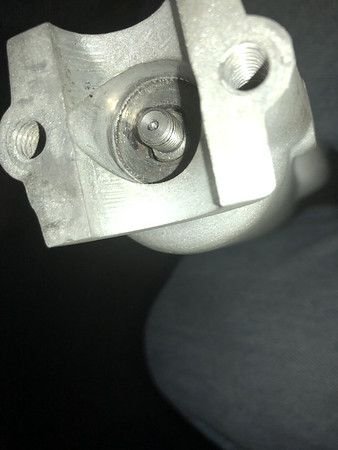

If the bottom of your fork tubes are leaking, one of the prime suspects may be this washer...
Goes here and the damper tube stud end goes through it
PITA to drive out and get back in. That stud will pull almost flush to the surface of the washer (hadn't tightened mine yet) One I did I backed off the nut, used a wee bit of yamabond, put he nut back on and called it a day.
Front end assembled. Stainless cowbells polished, parkerized nuts and washers holding them in place, polished lower legs.
