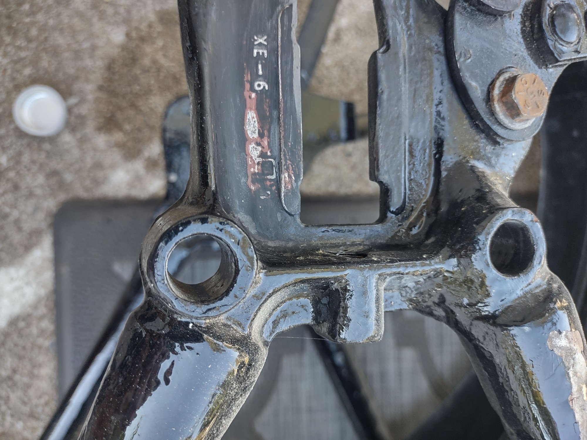

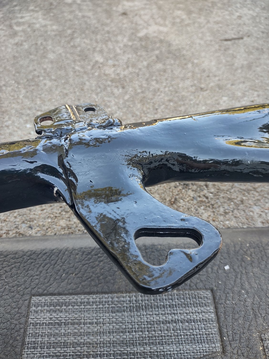

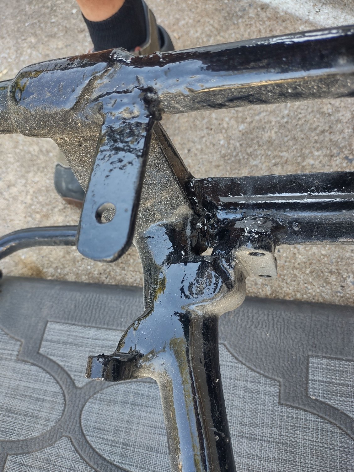

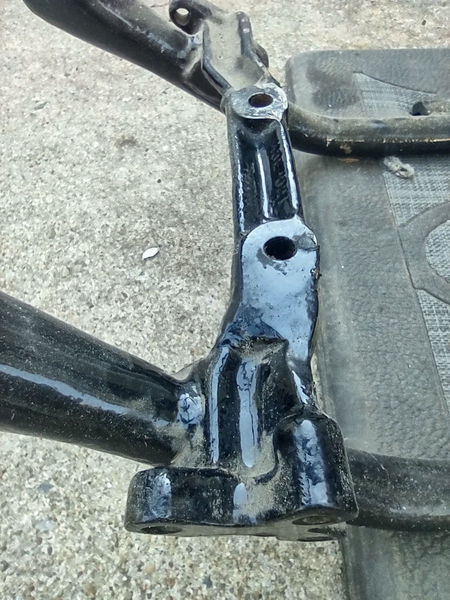

Amazing knowledge you have sir...! Please see the attached images for the shiny frame. I was able to locate more numbers. I used some acetone to get past the paint on the axle tabs. Question is now is the frame 100% original? I will post the rusty frame soon again.
Front bracing number.

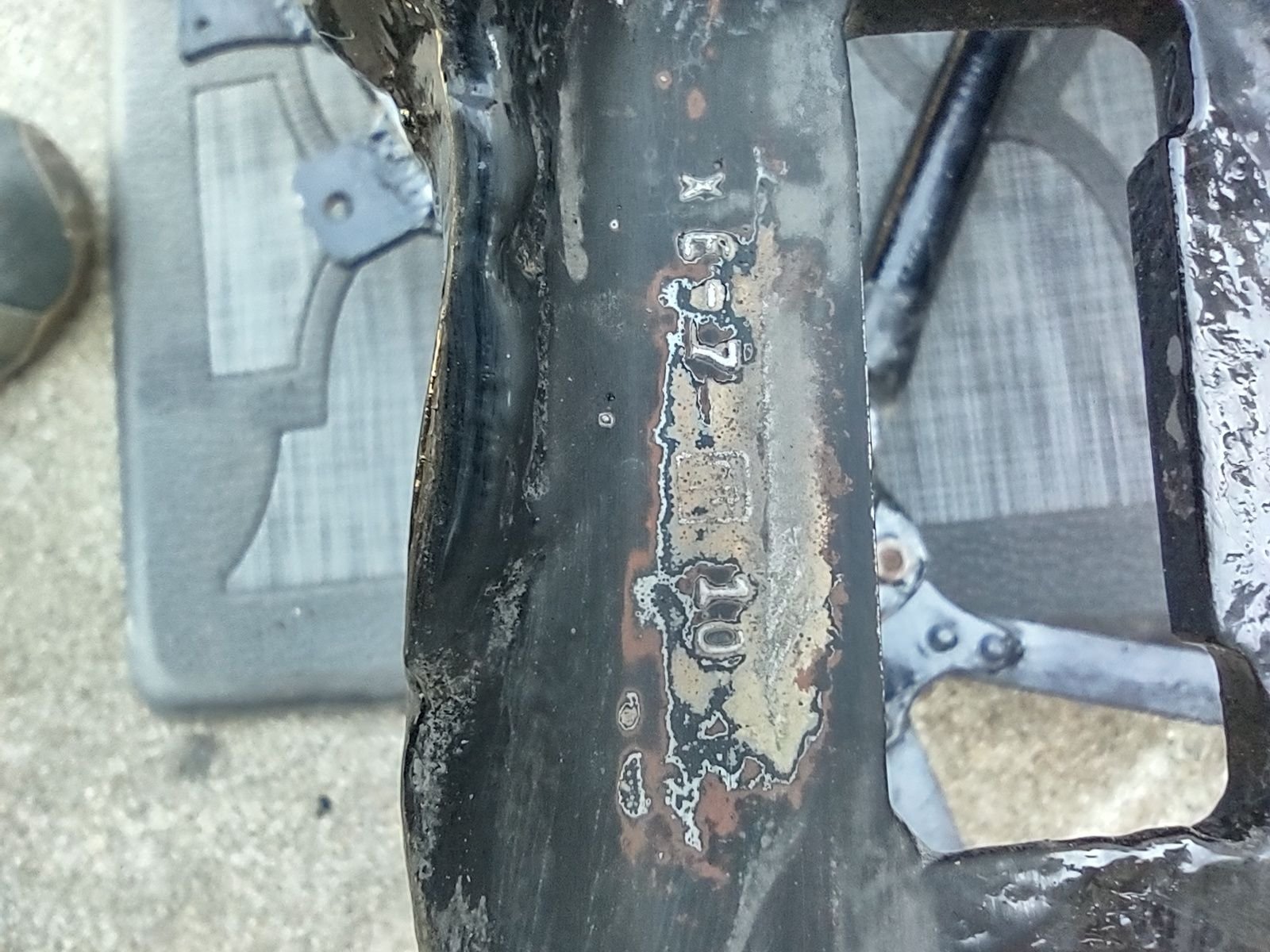

Axle tab number right side.
This has a stamped I letter as apposed to the X in the rusty frame.
Axle tab number left side.

XE-7 10 is 1948 on the left axle clip, a 48 frame thats been modified. If the upper engine mount is original to the frame then its an early 48 frame. Other die numbers may narrow it down as well.

The die number 10 on the axle clip is still 1948 but approaching 1949 which jives with the rib on the mount.

Thanks for the extra photos. Yes it's called a wishbone frame because of the front downtubes. If they were straight the frame would be called a straight leg. WB frames were used for 1948 thru about mid-54.
Re the area on the R-H side where the brake pedal bracket goes, markings there are something I continue to investigate. In this instance the letter I may just be an inspector marking.
Reinforcement of that type of top engine mount indicates later-48 thru 51.

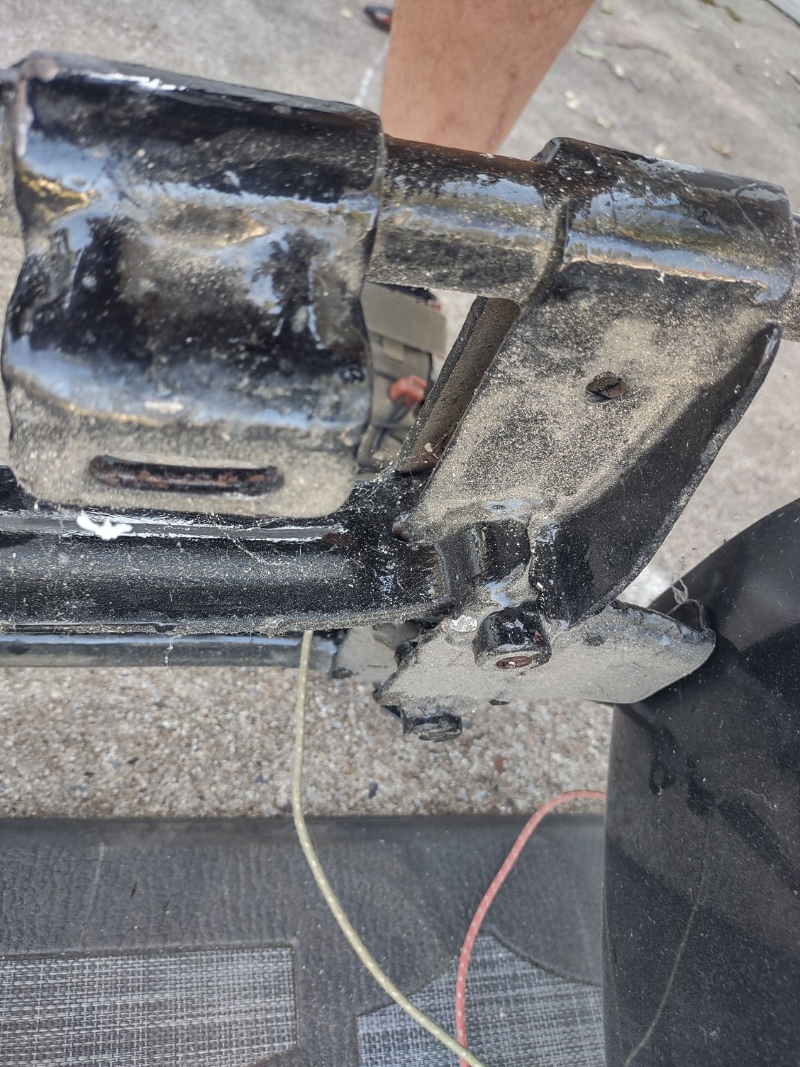

Your front engine mount has forging number 48E-621 which was used for 48–57. It also appears to have a forging die number which may be 2? If so it suggests the front mount is 49–50. Next to the die number is a forging hallmark which probably consists of letters M over F in a circle which represents Modern Drop Forge, the maker of the mount. Here’s your photo. Can you confirm if the die number is 2? To the other side the area I outlined in blue looks filled in as opposed to being a channel?

Next is another of your photos and it too shows that area filled in. Does that area look original to the forging?

I can’t see any markings under the seat post forging. Under one side you may find forging number 48E-1. Under the opposite side you may find forging hallmark M over F and a die number which may be 2 or 3? Photo?
Also look on top of the seat post forging. If a frame was sent in for repair the factory stamped a number on top. Photo?

Your R-H axle clip has forging number XE-6 and hallmark DIF. But what is the die number? Is it 7 or could it be something else?
