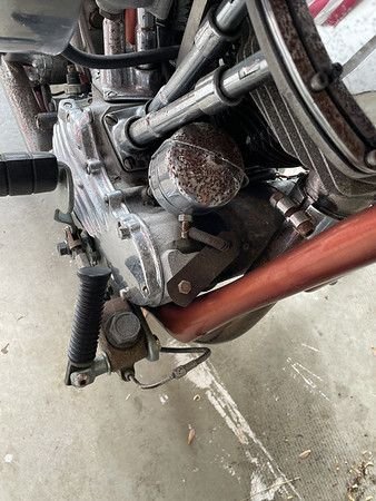

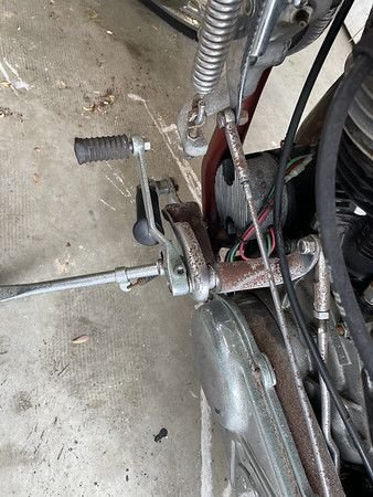

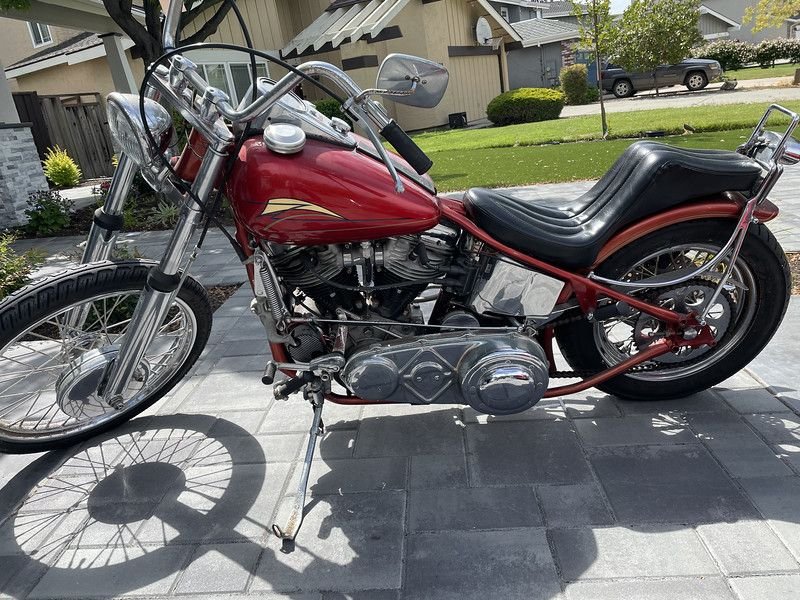

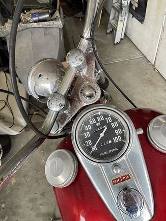

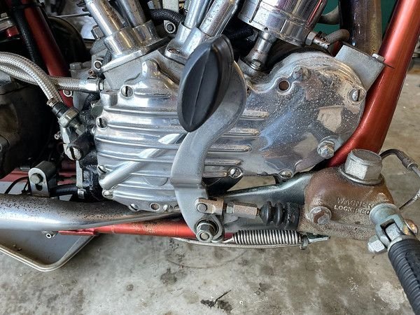

So this was delivered to me yesterday. It origionally belonged to my brother-in-law; it now belongs to my niece. Hasn't been run in at least 15 years. The last time I had it in my garage was somewhere in the late 90s/early 2000s when I removed the e-start that Michael had initially asked me to install (figured he thought he was just too cool for anything other than a kick start). He, my sister and their daughter relocated from California, to Arizona and to Florida. Somewhere along the line he checked out on life, on my sister, their daughter and his grandson. He rode the bike exactly twice in Florida and parked it. He is now in a full on care home (***** him).
What really bites is the he never drained the tanks (gas or oil).
When the bike was last here I also went thru the top end, brakes, wheels, tires, clutch, carb, vlave adjustement...the basics to get the bike up to par. Michael is/was not a mechanic. He was good at profiling and talking $hit, he could change fluids, and polish, but mechanical skills on a Panhead were not his strong point. I was cool with that and helping him maintain the bike.
So my sister has asked me to bring the bike back to life. It will be a bit of work. When I last had the bike it was a 3-kicker. Michael on a good day might get those results, But I have to say that in all the 20+ years we rode together, he always struggled to get the bike started (I awlays figured the bike just did not like him and his bull$hit macho attitude).
In addition to all he basics that it will need I am adding an e-start from the company in Germany (I believe John uses these folks as well). My niece is not the stoutest person so this should reall help her out.
Florida beach weather has not been kind to the bike. When the bike last left my digs it was all bright and shiny. This will be one of those threads that starts, stops and probably has long pauses before starting again since I still have the 96 to complete as well as finishing the 65 and the hack.
That said when it was delivered I told my sistser that just as before, the bike speaks to me. I sat on it, took it off the jiffy stand, righted it, and it was like reacquainting with a long lost friend.
The bike has good bones.

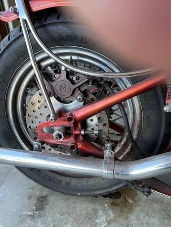

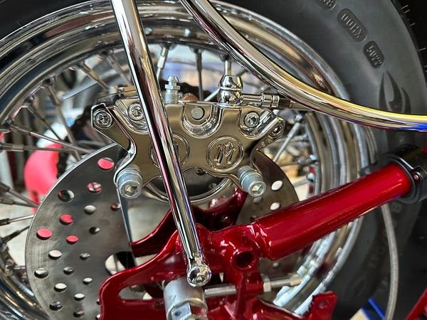

Rear brake is about ready for DOT 5 fluid. Used Russel lines and fittings. Took me a bit to determine the correct length of hose for each end (brake tee to rear brake caliper and brake tee to rear brake master cylinder) and then figure out the best/cleanest route of travel.
From this.............................................. .................................................. .................................................. ....to this
From this.............................................. .....................................to this

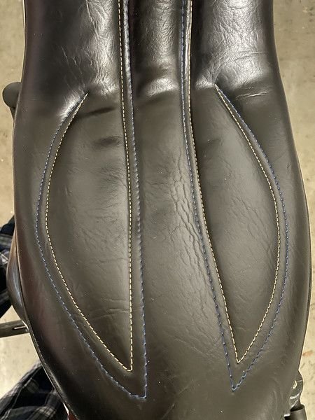

I love it. Can you take better pics of the seat please ,the pattern on it is what im after.

Thanks for the seat pics (rather than a cardboard box haha)
