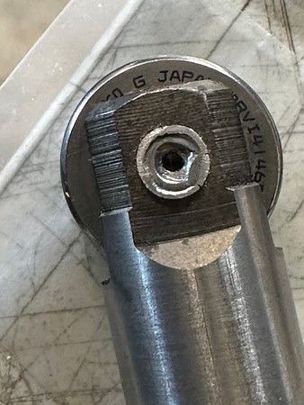

QUESTION FOR THE DAY PLEASE: I was going thru my stuff and came across these pistons. Are these for EL or FL models? Have a pair. Includes pins, keeperss and rings (Sorry for the supersize).

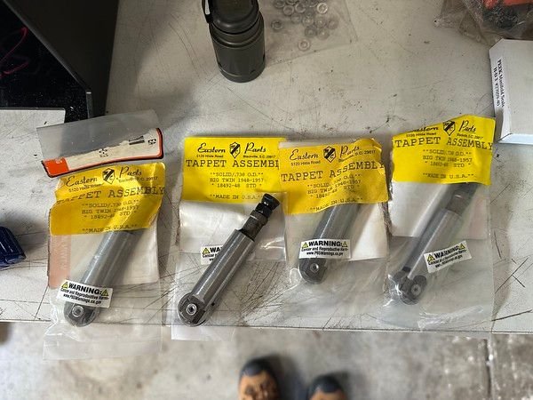

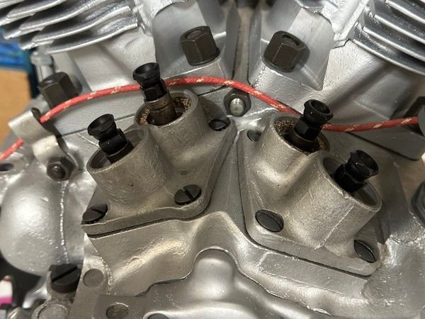

Lifter blocks are OEM aluminum. Tappet assemblies are Eastern (they use rollers from Japan, unlike the other named brand)

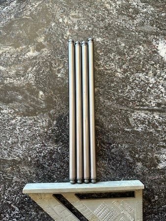

Pushrods are steel from S&S

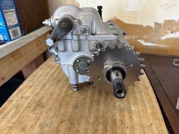

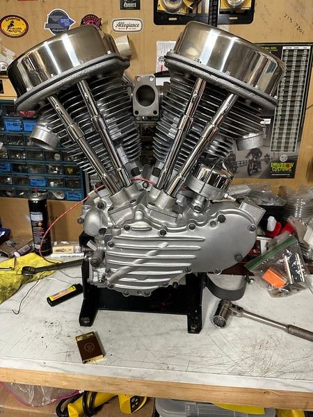

Motor is now completely assembled. Transmission is as well sans kicker sidestep up for e-start (goes in once transmission is in the frame along with the e-start).

And a special thanks to Twizted for the cork pushrod seals (saved me from ordering them because I had somehow forgot about them).

Great deal on the frame! Measure the piston, even just with a tape measure, that'll tell you.

Thanks Paul. Did just that as well as try to fit them in EL cylinders. Not even close. They are definitely FL.
