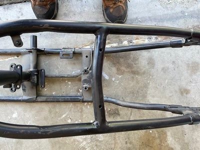

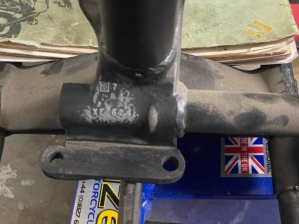

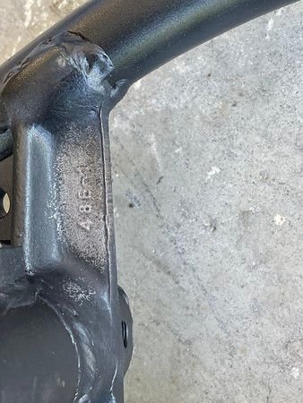

Some close ups of the '52 frame
Neck
Right and left axle clip
Front and rear motor mounts

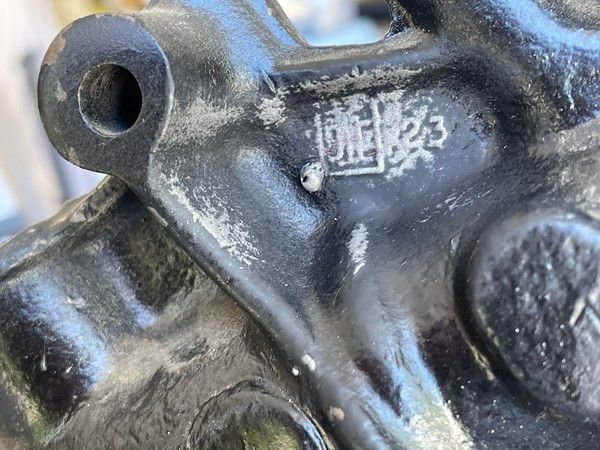

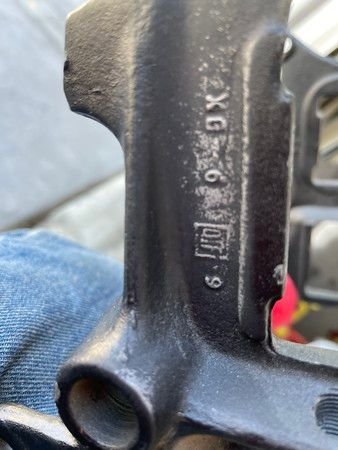

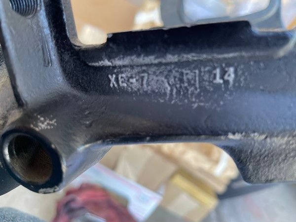

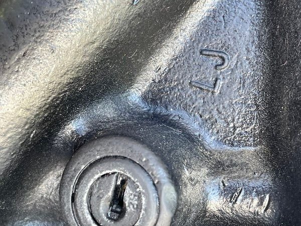

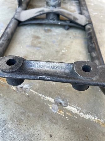

Have no idea what the letters "LJ" stand for that are cast in on the right side of the neck near the from lock mechanism. Also a pic of the upper seat post bracket
Bit of road rash down under but not bad considering the age of the frame.

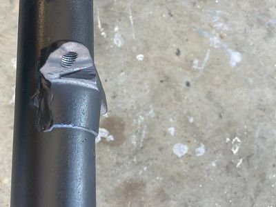

Left side of the battery tray mount needs fixing (been cut almost completely off). Couple of holes in the frame are gonna get filled
Gonna replace seat post bushing. Not worried about horn blocks of tool box mount

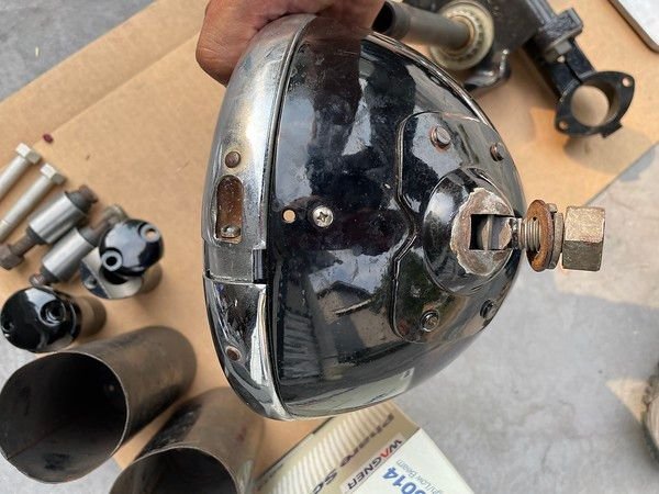

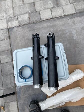

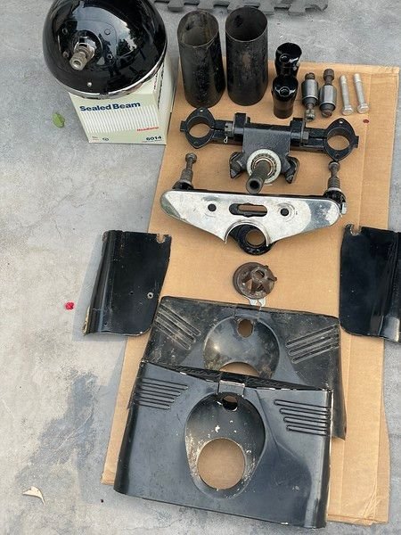

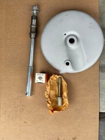

Front end stuff...a real mix-n-match bunch of parts

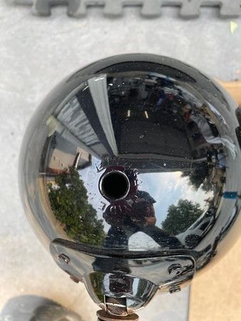

Steel headlight bucket with Wagner 12 volt light (running a 12 volt system). Steel fork slider covers and side panels (going to stay with black painted parts). Not sure which steel cover I'll use (50-54 or 55-59). Upper triple tree cover is stainless steel however.

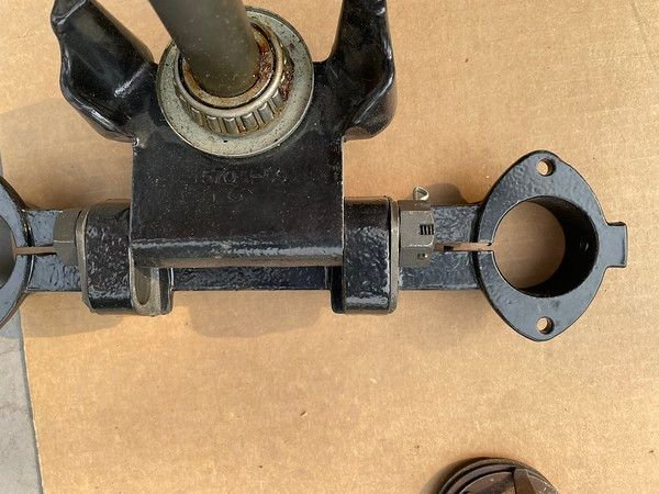

Adjustable front end
Headlight bucket

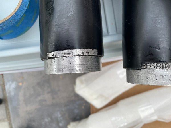

49 only tubes with new bushings
49 only brake backing plate

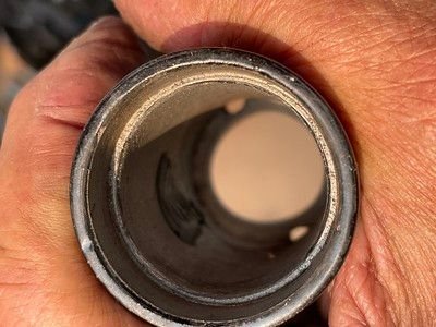

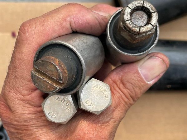

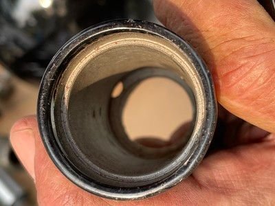

I need to replace the riser bushings. The metal sleeve portion of the bushings appears to be still inside the risers. Best way to get them out without screwing up the riser so that I can press the new parts in?

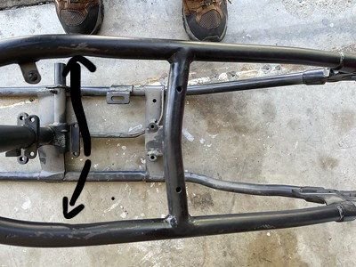

Whats the story there?

Sure wish I knew. Looks like someone used the Harley Hammer to beat the crap out it. Guy I got it from said he got it that way and didn't know how it ended up like that. Since it's gonna be a bobber build I figure I'll make sure the welds around those spots are good and fill it so it smooths out some. Kinda goes along with the grinding off on the battery tray amount on the left side.

holes in the cross bar and the spread in the frame sides tall me - a seat re fit - no one seen any of that stuff having any real value back in the day frames were 100 bucks in the 60s and you could buy a running pan head 500 bucks and

I changed the upper triple tree handle bar bushings on my 63' this weekend.
Used a socket and 1/2" drive extension. The socket was just shy of the same diameter of the hole. drove them right out with a 3# small sledge.
The first one I tried driving out the inside and then splitting the outside with a chisel. Wasted a bunch of time and only spent 60 seconds on the second one.
